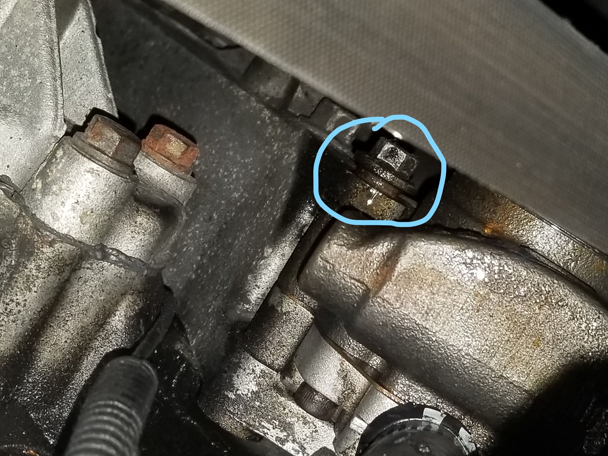

So after many clean and driving cycles,and the new LR high pressure hose gasket I still have a leak. The pump is newer, might still be the problem. I did seem to narrow down the location, it is not the high pressure hose and the first drip is circled below, it showing on the bolt. Any idea where I should be looking. It must be from above that bolt and leaking down on to it. I cant see where else that is.

Leaking gasket or cracked rear cover

The pump is newer, so I will try the gasket. Should rtv work, or do I need a gasket?

I usually pull the pump out of the bracket and leave it connected, spray pump with brake cleaner then observe for leaks. You may want to put some up dye in the oil first and run for a few days.
