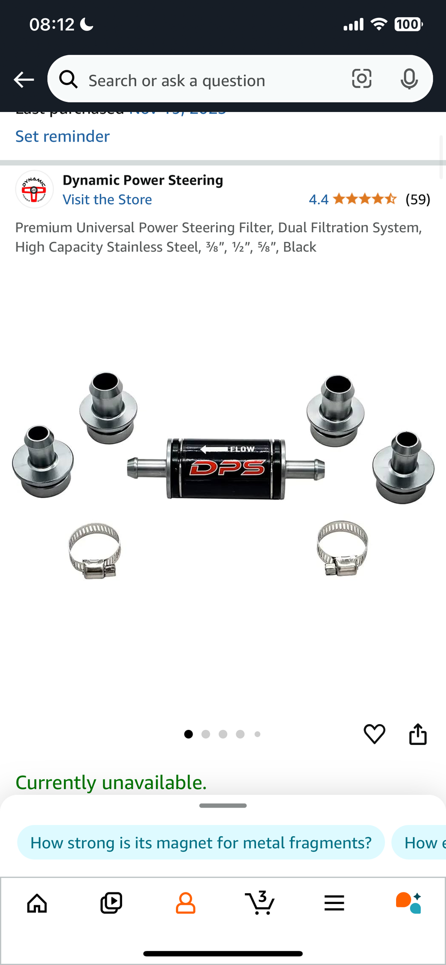

Default In-line filter I used…
I got a question about the filter that I used and thought I’d update here for anyone else with an issue.
My chief concern was maintaining flow rate, and there were some cheap plastic ones that may have worked, but I decided to go with this one with a magnet.
I had to install an extra loop of line, but it’s worked out well. I definitely feel better with the filter in there.
Also just to clarify: Had I not accidentally poked a hole in the in-reservoir “filter” I wouldn’t have installed this external one.
To anyone doing this job be sure to remove the reservoir and clean the filter by back flushing, shaking the tank, etc. I tried using the big syringe/pump and that’s how I ended up poking a hole in it.
