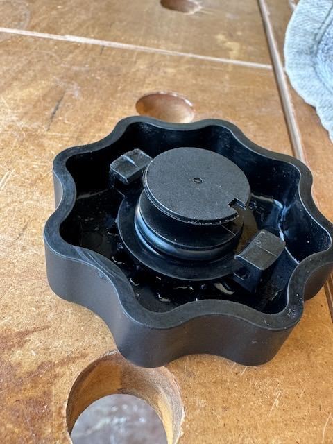

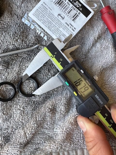

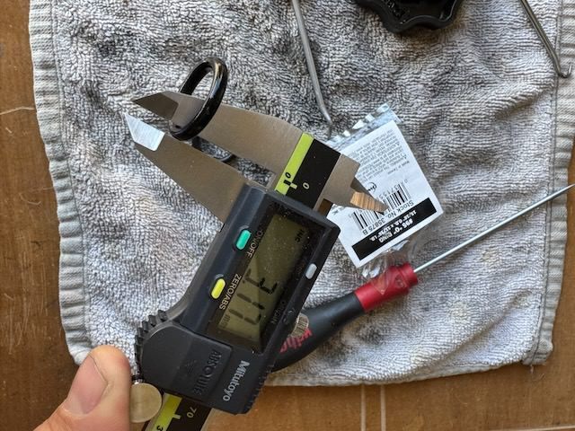

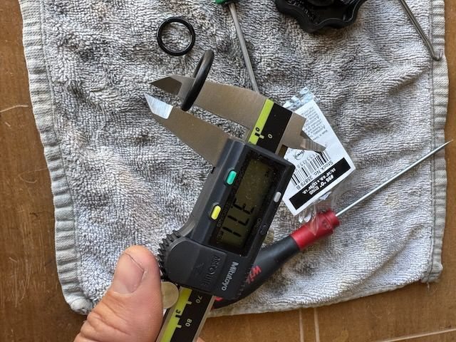

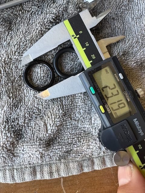

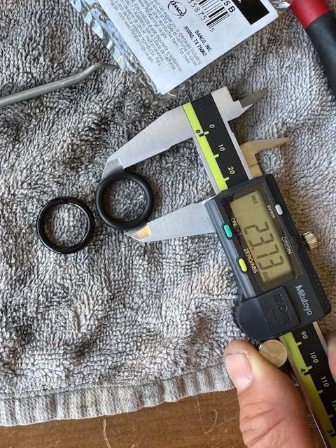

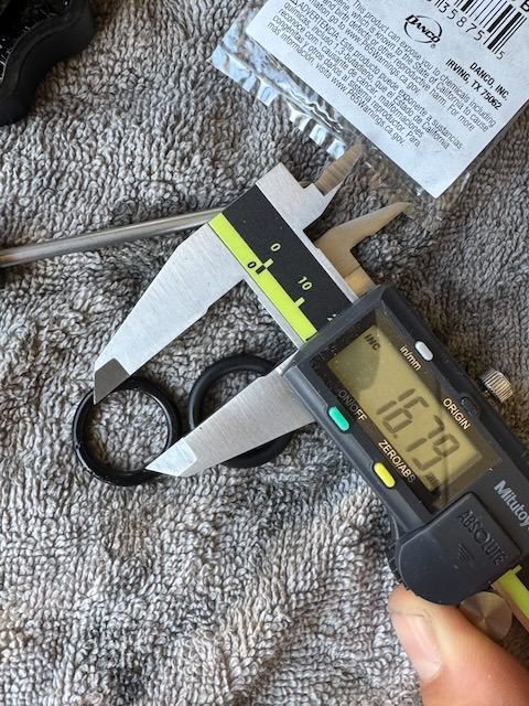

Welp, I ended up stumbling upon this post by @Discorama and sure enough, went to Ace, they had it, bought six because why not at .59/per. The dimensions are the exact same as the original one, any minute difference can be chocked up to compression and age, and just the general slop inherent in measuring squishy rubber. Swapped, installed, and what a solid feeling seal it made, just the most assuring amount of resistance. Hopefully this keeps things cleaner.
Original on the left, new on the right.
