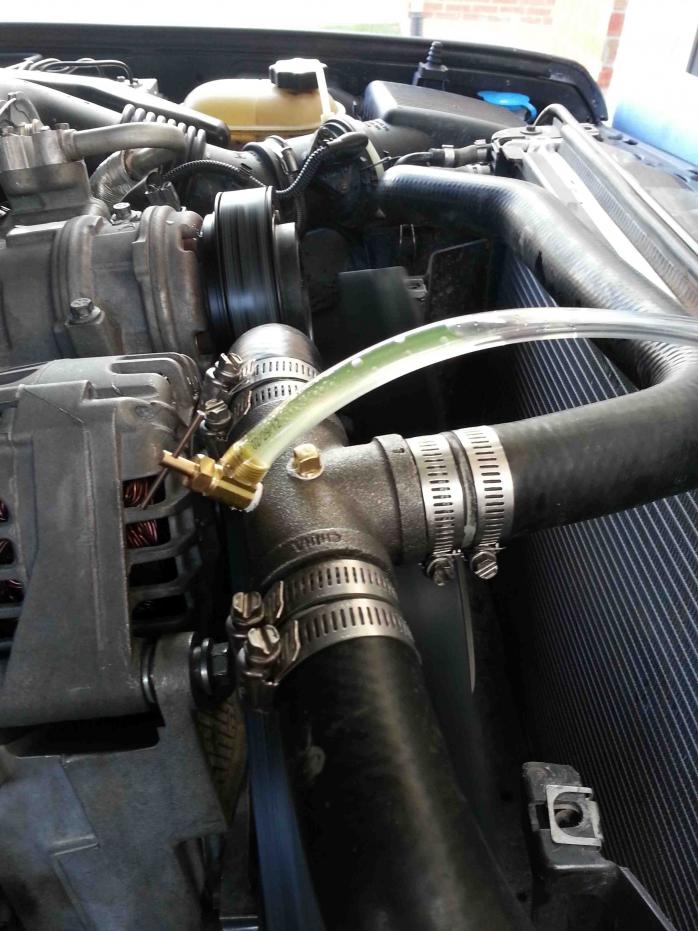

One member did a similar set up with a plastic hose that could be attached to bleed valve - less messy, and you can see the bubbles working their way out.

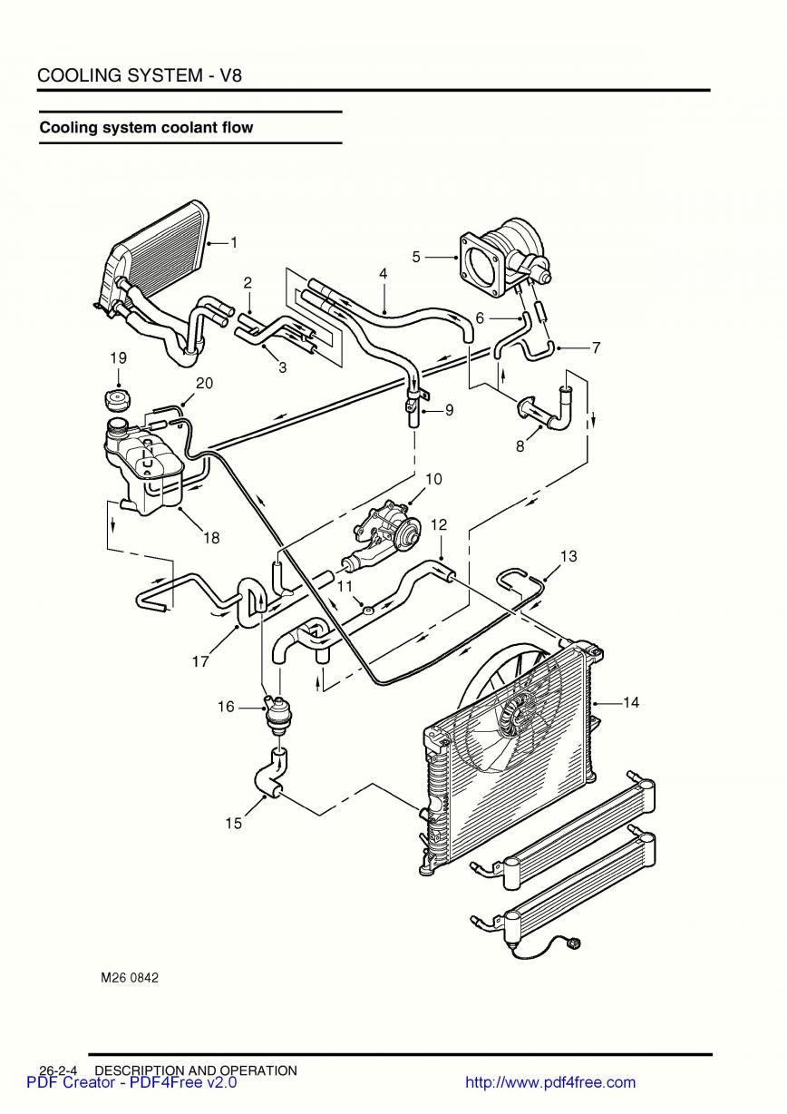

Not to thread jack but i have a question. my 2000 d2 doesn't have the bleeder screw on top of the fan shroud. Is there another one somewhere or do i have to update my hose to the Tee with the bleeder screw?
Old Jul 8, 2013 | 12:28 AM
Posts: 16,322
From: Savannah Georgia
That screw on the top of the radiator for a D2 isn't a bleeder and shouldn't be leaking.
Or # 11 in drawing.
Here is a home brew one.

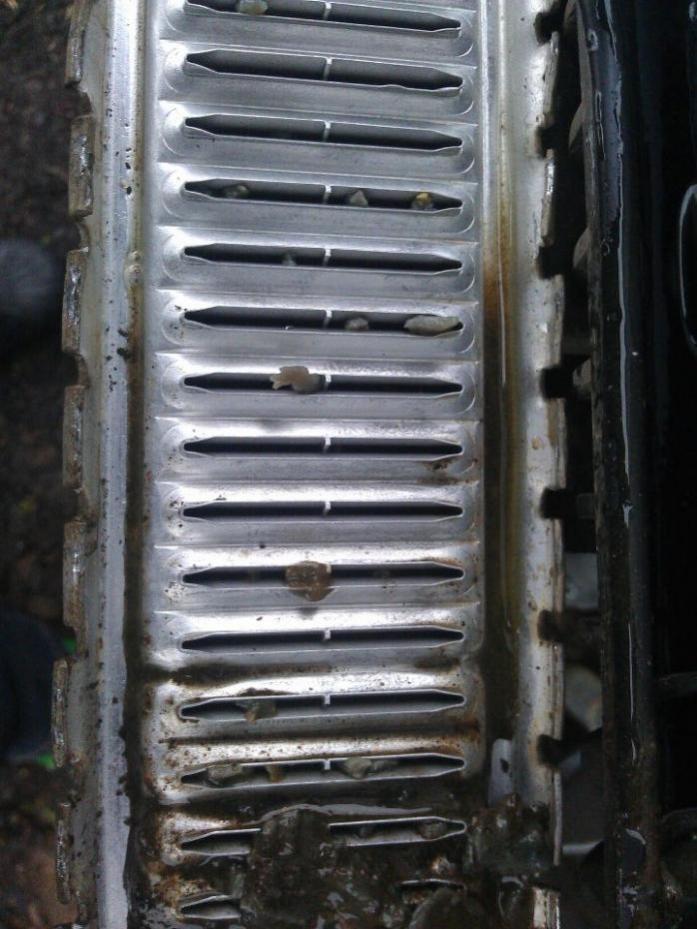

The Nissens radiator is fine. The rows in these radiators are so skinny to pack maximum cooling into minimum space. Just makes them easier to clog up, as the calcium and sludge build up has less cross-sectional area to fill up. All the radiators will be of very similar design. As for price point, you'ld have to wonder if the $135 land-o-panda is made with any kind of quality control. But any new radiator is better than a clogged up one.
Once installed, flush and change coolant 2 years or 30,000 miles, just like it says in the D2 owner's manual. Please, no Dexcool. Careful on DIY assembly, the mounting boss for the top screw is skinny plastic, easily overwhelmed by moderate force. The side tanks are plastic.
