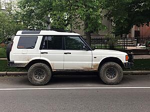

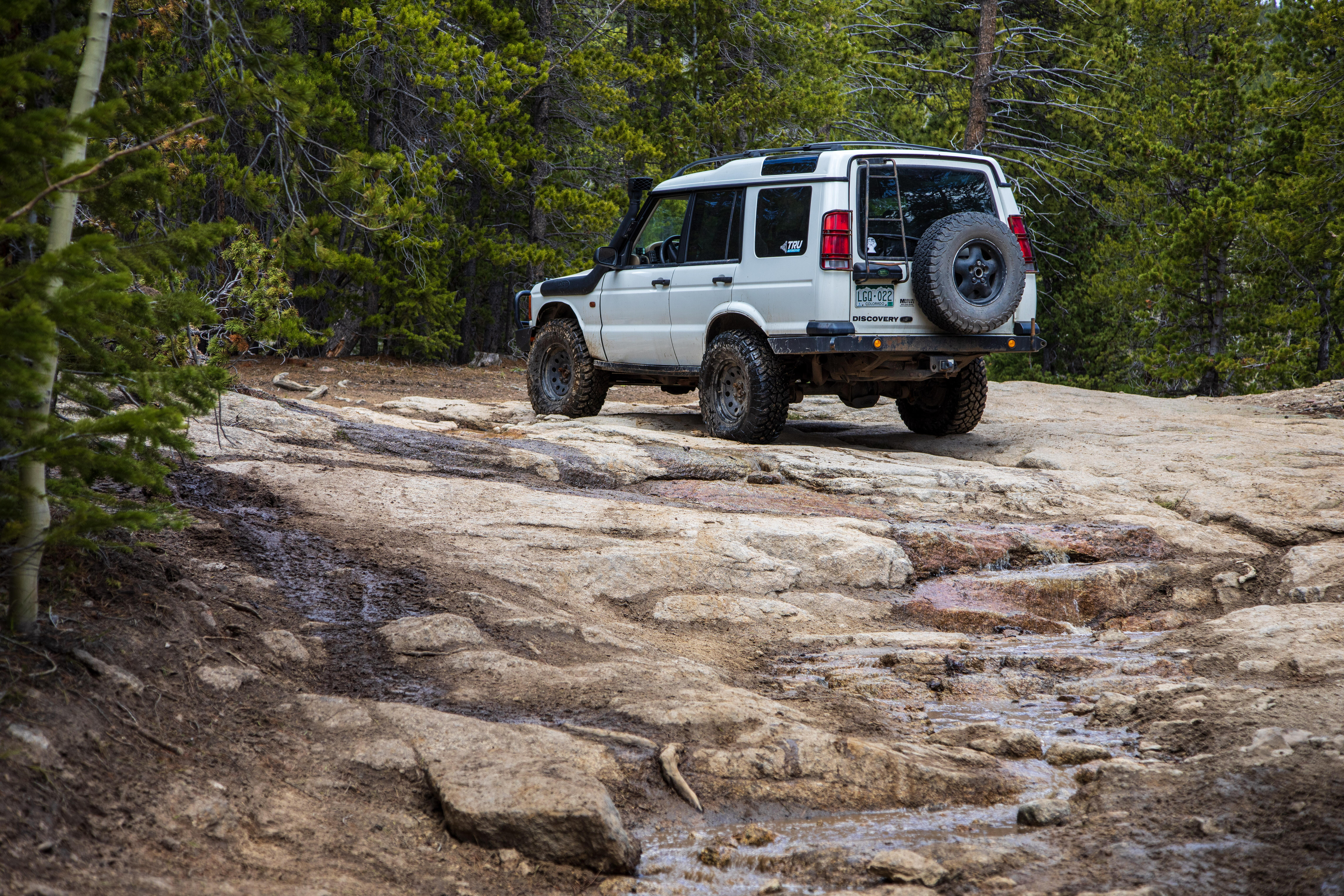

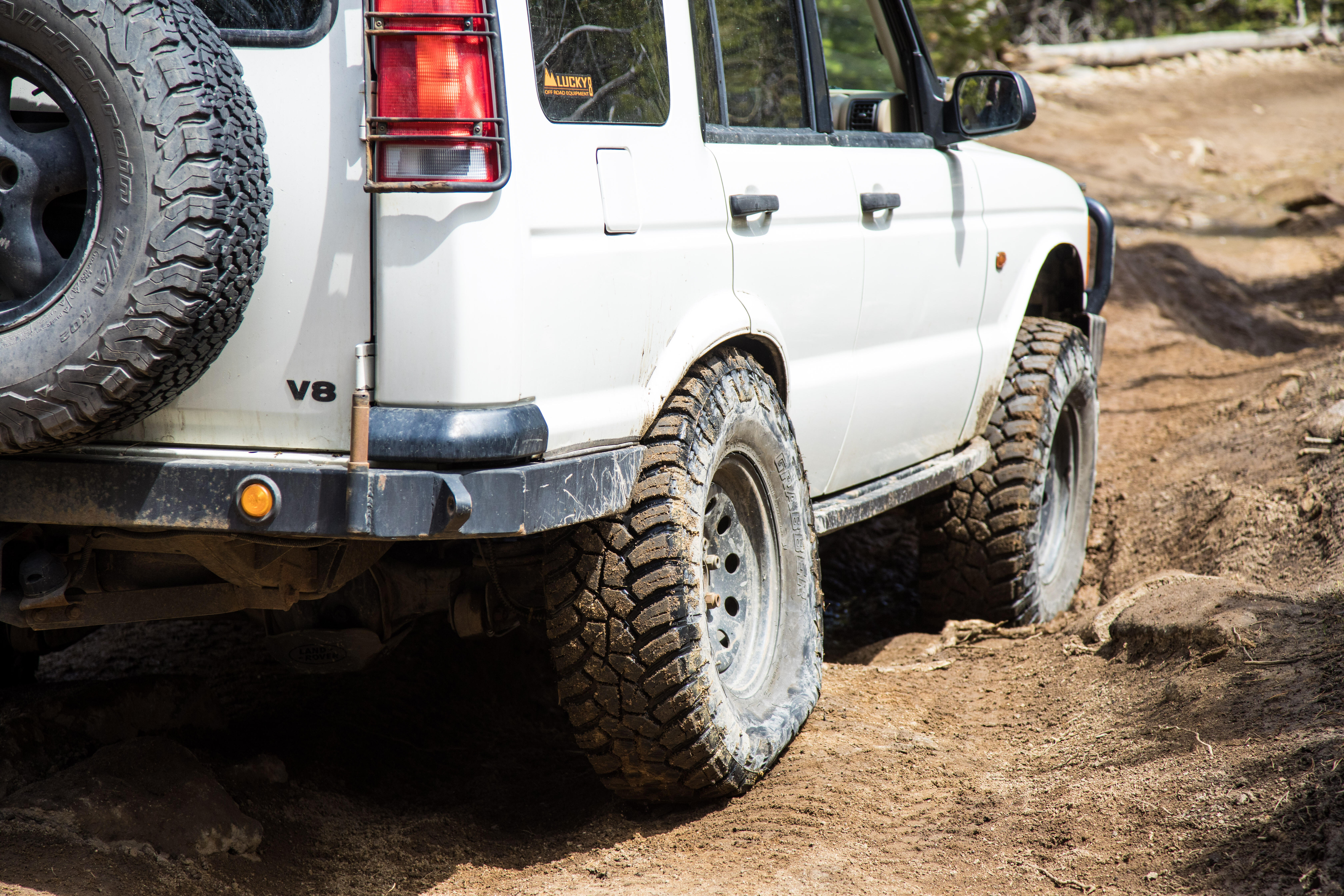

That's a tough one. I'd have to lean towards the sliders and diff guards but that's mainly due to the lack of bumper options that I could live with that are on the market (I dislike just about all of them). And I'm sure a custom one is going to run you more than a Lucky 8 or TF. Plus if you want a tire swing out down the road it might serve you well to go the custom route. I'm unsure of who made my rear bumper but It appears to be a fairly simple design and has proven to be quite robust. You can see on mine the rear quarter panels have been trimmed quite a bit so departure angle is greatly improved. Only complaint about this bumper is I wish there was straight away recovery points...tho I do have a trailer hitch so I carry a hitch mounted recovery point.
I do hit my rear bumper more often than the diffs or sliders but when I do make contact with the diff or sliders it is usually a much more serious impact (*** end is always sliding off of ledges vs getting slammed).
