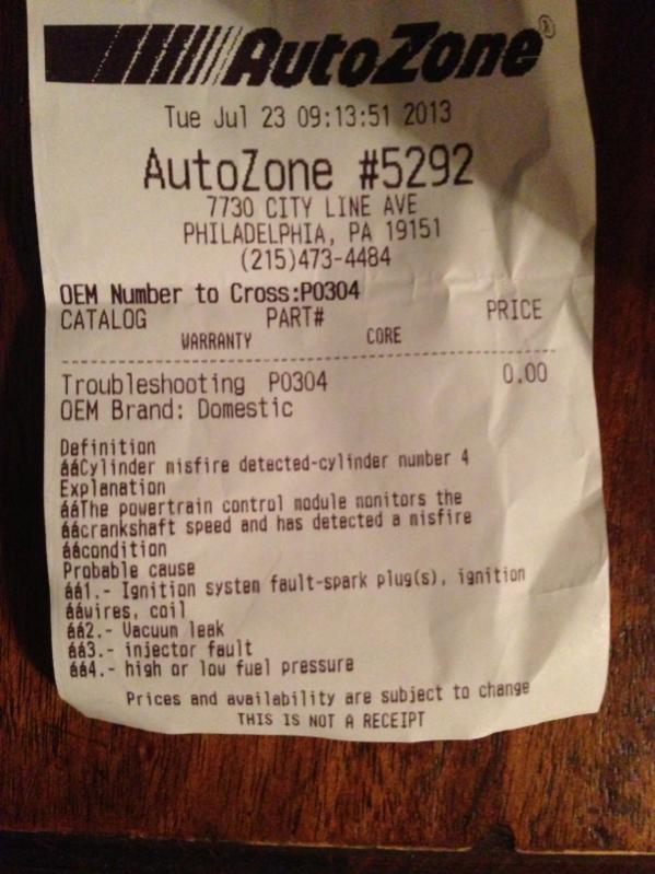

1.) when i drive the car, the service engine soon will come on and off periodically with the car making a tone (sometimes the tone is accompanied by the light other times there is no light and a tone) this has occured for the past month
- in regards to this the only thing that I have noticed is that around the second or third gear as the car drives, it almost has a throb that you feel as it stays within that gear, and until you accelerate or decelerate it will continue to do so (maybe the pistons not firing properly)
-I have however changed the oil within the past week, checked brake fluid and other fluids and determined that they are all up to par
If the check engine light come on when you are driving it -
this means CATALYTIC converter damage is occurring.
SCAN it for additional codes.
do not drive it like this.
3.) as for the rear fog light and front one I know they are 2 different buttons, I was asking whether or not they are setup on a fuse or not
4.)I have already checked the seat with your recommendations, but I am saying that in the up right position it does not lock in place in fact the latch itself at the top next to the headrest is up and not down in the lock position (in the position that it would be when you pull the latch up, basically stuck)
External
For the engine light I don't have a code scanner yet
Ok thanks for the insight, any idea how much that runs?
