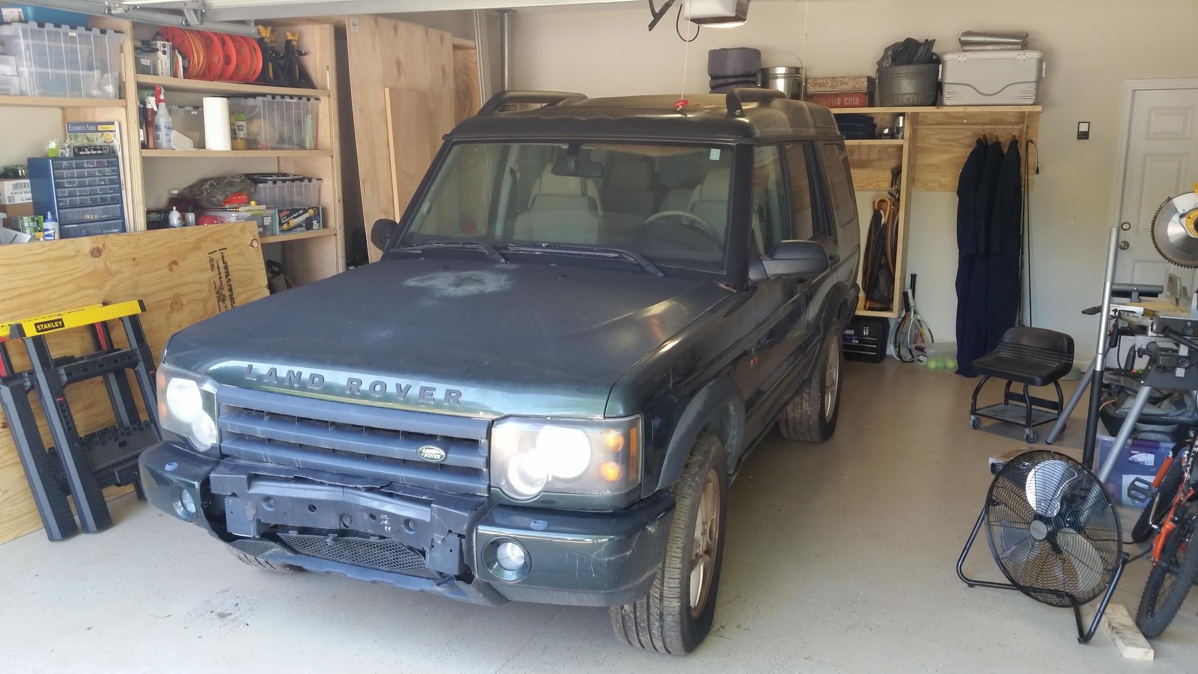

Finally got her towed home from the mechanic I bought her from. So its sitting in the garage, ready for attention. Wife did a bit of cleaning in the interior. Exterior and underhood still needs to be cleaned. AFAIK, the engine is probably a goner. Overheated more than once, fatal blow to previous owner's wallet was a catastrophic coolant leak. Its been sitting for over a year. I'm currently planning a Chevy LS swap, but I'm still formulating my plan of action. Right now, I just want to find out everything that needs work.
First snag. I hooked up a battery charger, just to see if it would take a charge. I really think it wont, but hey lets see what lights come on...
Well, the thing starts honking the horn immediately. Fortunately, clicking the remote on the key stopped that.
Also, the transfer case shifter seems to move freely between what seems like "bottom center" and "bottom right" positions, but I can't get it to go anywhere else. The car has a nice figure eight diagram that doesn't seem like it is going to happen. Where do I start with this? I don't want to break anything on my second day home with it.
It's a little overwhelming to figure out everything a vehicle like this needs to be done, but it should be fun. This is my first LR and first British car, so I have a lot to learn.

I would diagnose what you have for a motor to work with before heading to an ls1 swap.
a terrafirma bumper on the front and used a hood black out decal to cover the damaged clear on the hood

I do plan to at least try to get the original motor running. I plan on getting the motive power (?) Coolant hose adapter to pressure test the coolant system. If anyone has a good idea on that front I'm all ears. If I can get it to not spray coolant, then I will change the oil and gas and try to crank it. Getting out all of the gas out should be fun...

Also, when I turn on ignition I don't see three amigos. Is that good news or should I reserve judgement until after the motor runs and it drives?
I'm trying not to be unrealistic since this thing is a total unknown and it has been sitting for a long time.

It's good if the 3 amigos isn't showing. The ABS sensors SHOULD be OK as they are lubed and also the ABS modulator may be OK (low mileage truck) but you will need to bleed the brakes to change the brake fluid as it's hygroscopic. Follow the bleeding procedure if you have a good interactive diagnostic tool or get them bled at the LR main agents. Good luck. (Stay away from the coke ................ it's brain damage powder).

You can get a coolant system pressure tester that connects to the rad. They are relatively cheap online on Ebay. Check out the system test pressure for your truck in the RAVE manual. The RAVE manual download is available on this website.
Before you start the engine ensure you turn it over on the starter for a minute or two in 30 second bursts with rests in between (to prevent the starter motor overheating) to ensure the oil is circulating. To do this remove all the spark plugs first.
