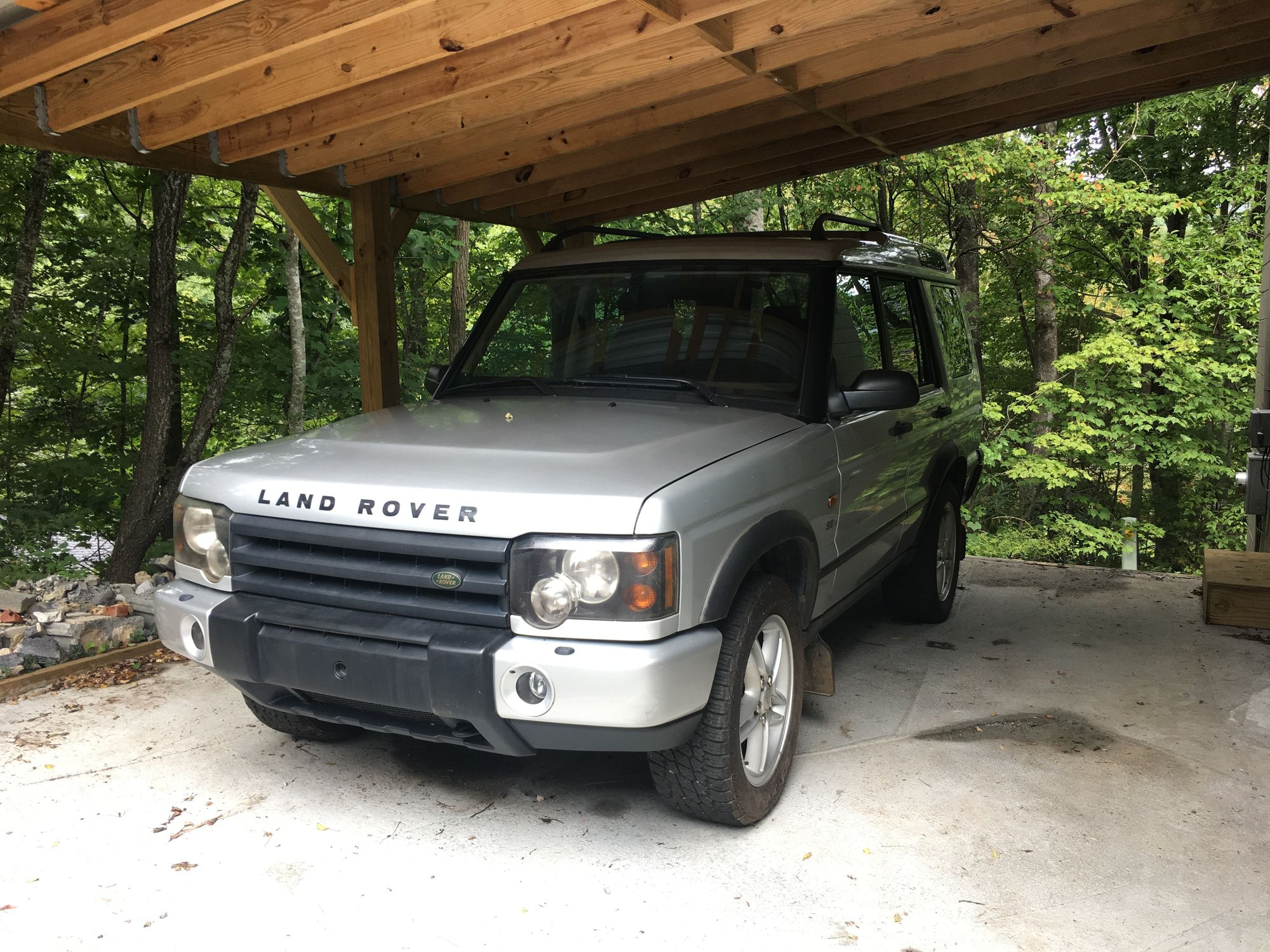

Bit of an update:
So I got the truck back to my house and further investigated. It's definitely not running on all 8 cylinders and has an idling issue likely for that reason. It idles around 700 rpm. The engine knock is only present and loud when you give it rpms. I will upload a video of the knocking sound soon!!
Looks like a pretty nice truck! I had a similar endeavor with another truck for $600. If I were you, I'd pull the oil pan and take a look for a slightly loose bearing and pull the plugs to see what they look like. Maybe run a compression test.

Agree^^^sounds like multiple noises. I'd start by removing the belt and eliminate that suspect (pulleys, idlers and such). Check your exhaust manifolds closely, had one go on my 01 that sounded very similar to your beast (pass. side), bought a used one from Paul Grant, nice condition and fast shipping. Also check the crappy SAI tubes, they can become quit brittle over time...and the slightest crack can sound pretty substantial.
I'd probably check vacuum, compression test and monitor oil pressure to see where it stands mechanically.
Good luck, and report back with your findings.
Nice looking rig, hope she's salvageable.

Thanks everyone for chiming in! I'm moving off to college tomorrow so I won't have as much time to spend on rovers. Not exactly the best time to acquire another one haha.
A compression test will be done in the near future. I'll report back.
Could you tell what part of the gasket blew? I feel like a leak between two of the cylinders would do that. Performing a compression test soon.
