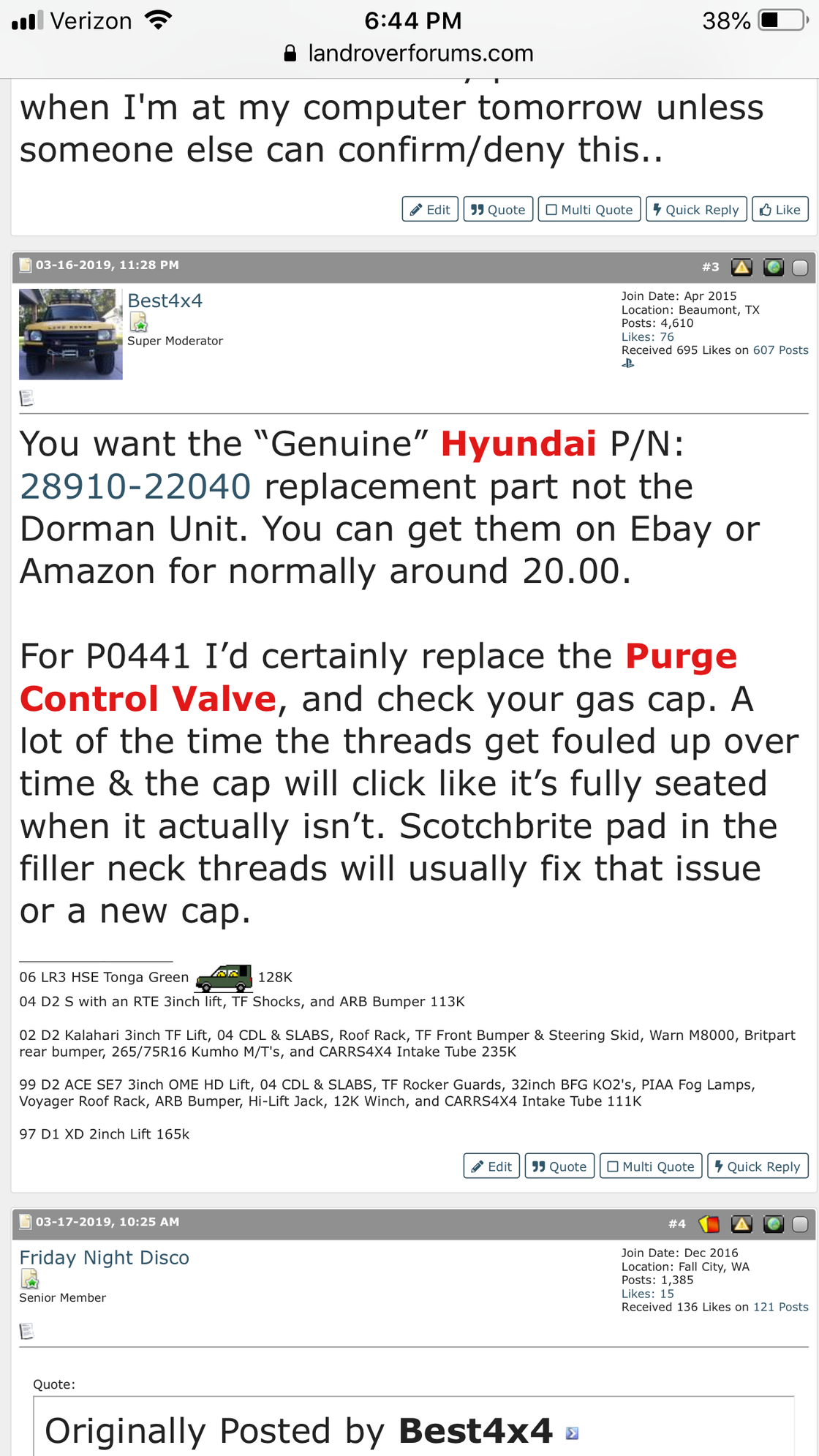

So I got the p0441 in my code box. Just do the Hyundai valve? The auto parts store here said they didnt have it but they had a 42 dollar equal.
I did the Hyundai. Shop around?

So with the 0441 code a simple change of the purge valve fixes it? Nothing is ever that easy

Grab the Genuine Hyundai unit off of Ebay for like 10-15.00. I’ve cured P0441 with em for years.

What's the Hyundai part #?

Didn’t have the P/N handy but a quick search found my own post from earlier this year.

I will be able to clean mine with brake cleaner using an extra battery I had to toggle the valve open and closed as I sprayed brakleen in it. I did that six months ago, and the code has not returned.
