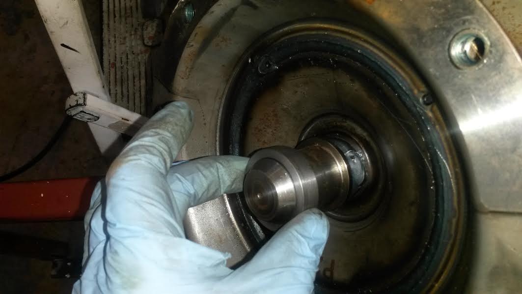

The Rover torque converter pilot shaft is a bit smaller than the back of chevy crank so I had a spacer made for installation alignment. Even though the crank, converter and spacer all move together, I don’t want the spacer sliding back on the shaft while running so I secured it with a couple of set screws with thread lock.

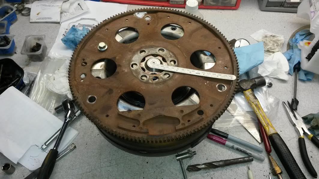

With holes drilled into the chevy flywheel and torque converter in place, I need some additional clearance to accommodate the Marks adapter plates I am ordering. To accomplish this you need a shorter torque converter.
Since going out and finding one looks to be a hassle, I’m having the bell housing milled a few thousandths on each end.

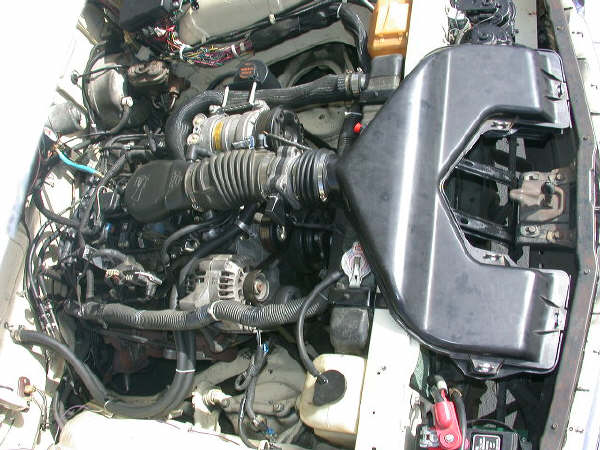

My '97 4.3L GM wrapped in a '62 Cadillac, attached:
Attached Thumbnails Putting a Chevy Engine in my Discovery II-vortec-1962.jpg
