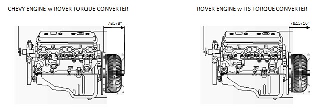

Default Some measurement info
The distance between engine base and transmission end of torque converter when installed is 5/16 or 8mm longer in the Rover engine.
That measurement is the total thickness allowed for the adapter plate unless either a shorter torque converter is used or additional distance is achieved by shortening the bell housing.
Marks RV uses a total of 17mm thickness for their adapter plates. Therefore to utilize these adapters (which is probably the best mearsurement to accommodatee attachment bolts) we need to remove a total of 9mm or 3/8” from either or both sides of the bell housing. This can be accomplished by a machine shop and I will report on how much to take off each end to best achieve the objective.
Marks RV solution is to simply use a shorter torque converter from an earlier model Rover. But after consulting with several torque converter, Rover people and bone yards about this my findings are that it’s a very difficult task to find one.
