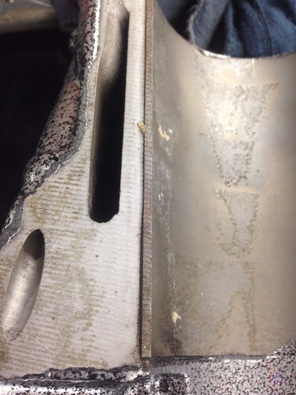

Old Jun 2, 2015 | 04:09 PM
abran's Avatar
Posts: 6,919
Likes: 794
From: Huntington Beach CA
Here is a photo of the cutaway block they have at the shop. Unfortunately I didn't get a photo of the top part where you can see there is a good amount of material for the Top hat sleeve. This is a stock sleeve in the photo. The Top hat ones have a small recess near the base for an o ring.
The issue is the walls between the coolant passage and the sleeve. I am not sure what quality block he used for the cutaway.
