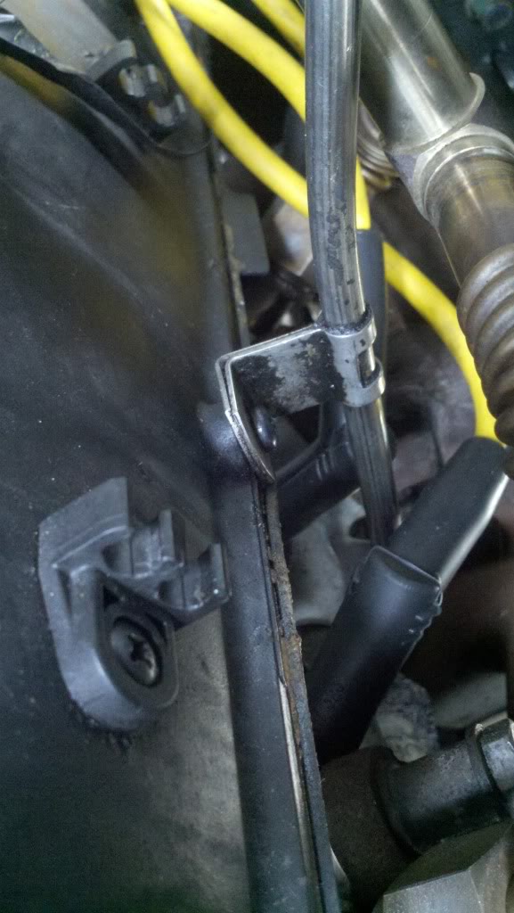

So i went out to take a last look at my truck before ordering parts to see if i could find any other parts that might need replacing. while out there i crawled under and noted that theres a screw missing under my engine but im not sure if its something i should be worried about ( pic below)

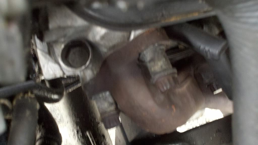

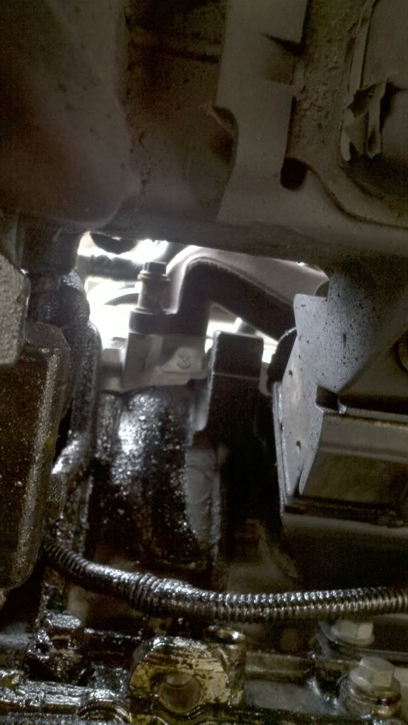

second, while under there a noted what looked like a oil leak under the exhaust manifold. i need help identifying a possible gasket i could replace in that area, please take a look at the pics below. one picture was taking under the car and one was taken from above.

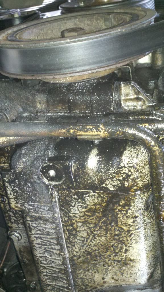

last i took some pics of my left side rocker gasket just to see if anyone can confirm if it needs to be replaced or not. i think it should be, just looking for other opinions. id really appreciate any help i can get guys, thanks.

Many owners find that the valve cover gaskets loosen, and need to be snugged up every oil change. They leak down below. Bolts are 8mm 12 point, skinny socket (3/8 necked down, or 1/4 inch drive). You should wash off the engine before work to locate leaks (power wash at car wash, degreaser, etc.). If you will be removing the oil pan, it can be washed out. Yes, good idea to spay some oil back on inside before assembly (squirt bottle), but engine will do a pretty good job of spashing oil around when re-filled. You can use oil flush before draing the oil (follow instructions on can), but that won't get the big stuff in just a few minuutes of use.

Perhaps I did not make myself understood. Valve covers frequently leak oil, dripping down on and around the exhaust manifolds. The covers leak oil because the the bolts holding the gaskets loosen, many owners snug up the 8mm 12 point bolts, four per valve cover, evey oil change.
