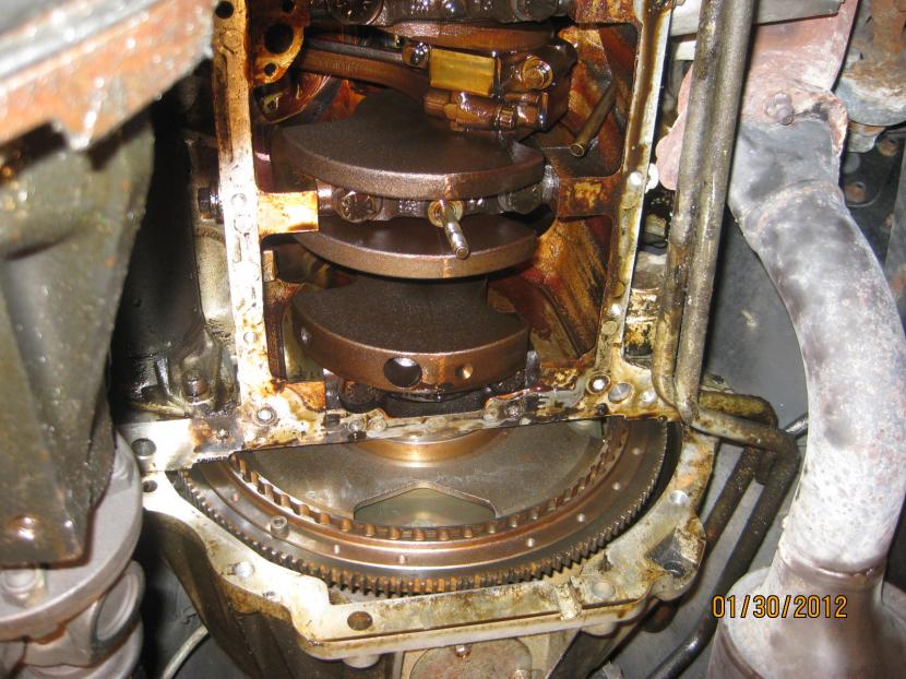

Valve cover leak common, many owners snug up valve cover bolts (8mm 12 point 1/4 inch drive) every oil change. If you have to replace oil pan gasket an afternoon with truck up on ramps. You can use a gasket or Right Stuff.
Download factory shop manual set, called the RAVE, includes owners manuals. The 3 Amigos are in your future.
