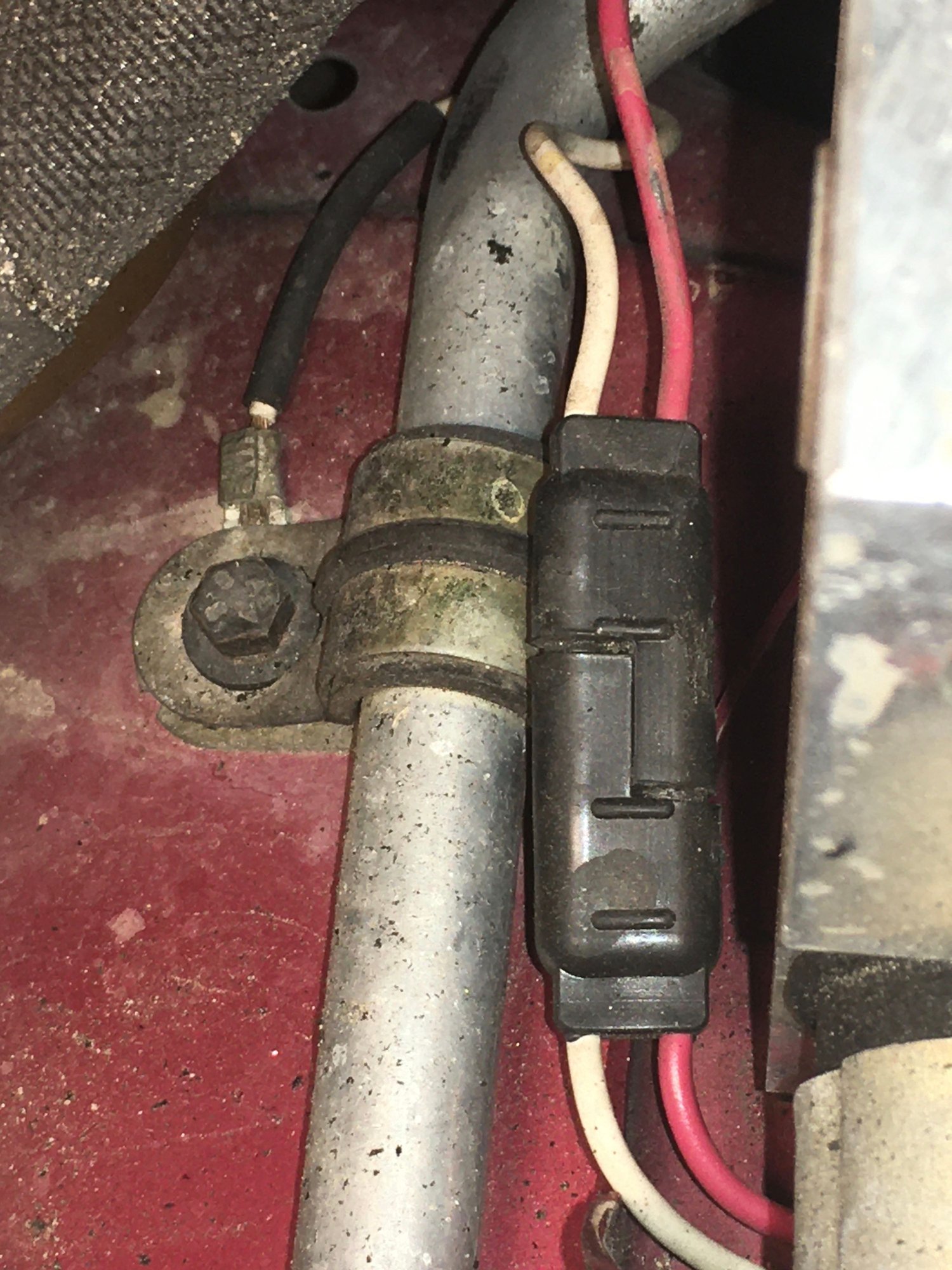

Option B bypasses a faulty solder connection between the shuttle valve switches and the wiring harness back to the SLABS computer.
I'm a little confused about your statement that the codes you found were for the front-left and right-rear valves. More common would be codes for the wheel speed sensors, not the valves inside the ABS modulator. The connectors for the wheel speed sensors are a common failure point.
But as others have said, I'd also check and clean up the ground for the Option B bypass. Even Josh Salas, the demi-God who came up with Option B, had the Boys from South of the Border come back on his truck due to a faulty ground connection.

Where is the ground connection? The RAVE diagrams I have show it near the hood button. Either that's not NAS or I'm overlooking it.
Old Jul 1, 2022 | 12:46 AM
mln01's Avatar
Joined: Dec 2009
Posts: 3,893
Likes: 958
From: Charlotte
The ground we are talking about here will not be found in RAVE. It's the ground point created when Option B is done.
Josh Salas chose to use the refrigerant line clamp bolt next to the ABS module as the Option B ground. That's what I did (pictured here).
