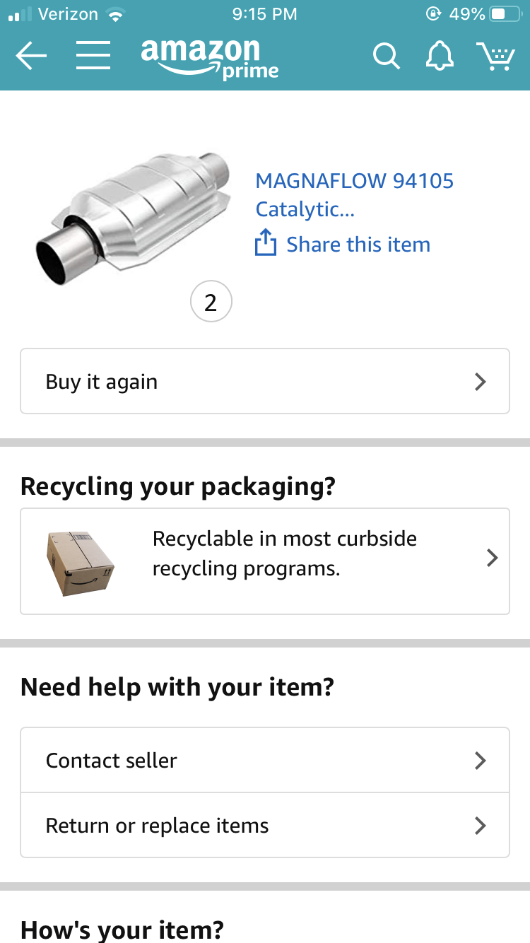

Magnaflow #99004M, #93689, or #94105 as stated above.
