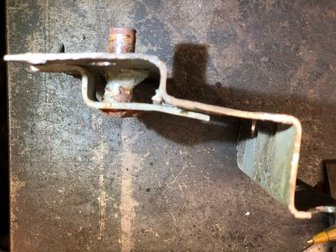

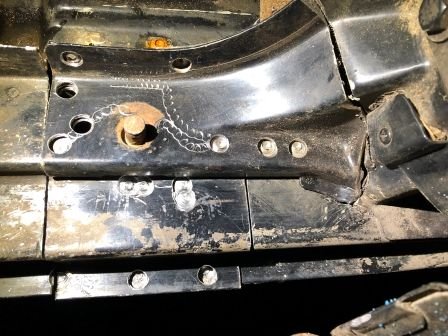

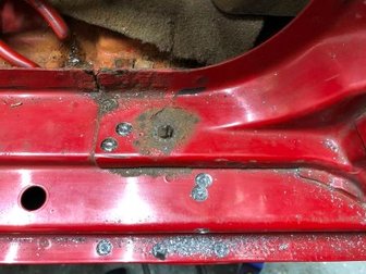

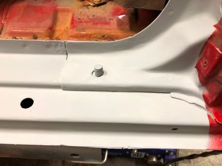

My pin was cut off down to a nub by previous owner. I had a donor car with a good pin. I understand you can purchase the pin, but it is welded in place and I don't believe there is any way to replace it without cutting panels. In the first image I show the donor car with some spot welds cut out and the panels cut. With the top cover over the pin removed (2nd image) the panel that holds the pin in place is revealed. Note that it was a mistake to cut out the two spot welds above and two below the pin. The third image shows the panel holding the pin after removal from a side view. The next image is that panel from the bottom showing how the pin is welded in place. The last image shows the trimmed panels installed in the receptor car, welded in place and the welds ground flat. The next step is to apply a layer of body filler, primer, and paint.

Not recommending this for everyone but maybe it will help the next person trying to install the pin you can buy from the dealers. Short answer is you can't. Mine was too far gone to even drill into but I had a donor car and welder. The pin is welded into a layer of steel below the surface. In the pics the red car is the vehicle being repaired and black the donor.
Just a nub.
Donor Vehicle.
Side view of part removed from donor.
Welded.
Cover piece welded.
Ground.
Primed.
