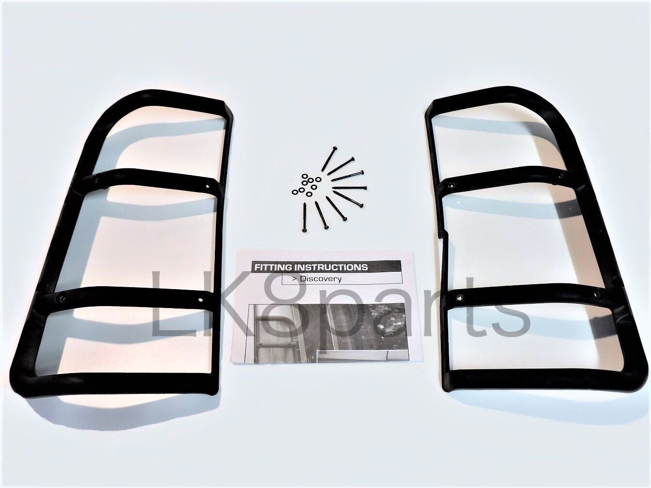

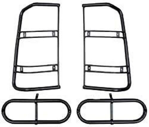

Does anyone know if the metal guards (STC50379) can be used with the 2003-2004 rear lights, or will only the plastic ones (STC53194) fit?
Metal Guards STC50379
Plastic GuardsSTC53194

You can use them on the later trucks. I only have the upper metal guards, and cut small lengths of aluminium tubing to act as spacers so I can't overtighten the screws and crack the lenses.

Metal guards work on my 2003....no issues

Yes, they are usable if you use spacers and longer screws. Mine actually came with those guards.
The guards stand off from the truck an inch or so, so there is a risk of the guard catching on brush or limbs.
