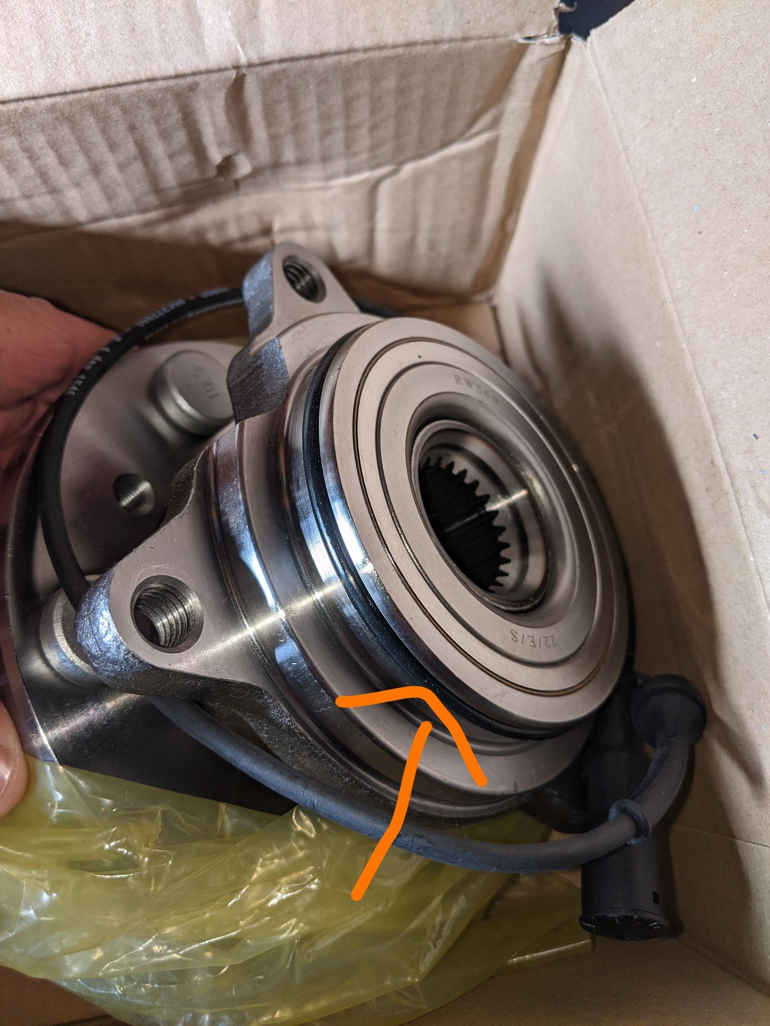

While out in the backcountry of the Inyo mountains I lost a rear wheel hub bearing. Got home took it apart and ordered a new assembly from ABW.
Hub assembly arrived still waiting on the castle nuts from Rover's North. As far as I could tell they were the only US retailer that had them in stock.
So I have two questions about reassembling the hub assembly.
1. I've attached a picture showing the axle housing where the hub assembly mates up. If you notice somebody used silicone, I presume to stop it from leaking gear oil? I'm not sure why they would have done that unless the housing is damaged? Or is it a preferred practice to lay a bead upon install? You'll notice on the new wheel hub bearing it has an o-ring perhaps the old wheel hub bearing when it was removed and replaced they didn't put an o-ring in there?
2. The previous owner cut all the ABS wires on all four corners. It goes without saying I have the three amigos. My understanding is that one thing that ABS sensors do is let you know that there's a problem at the hub. So for instance if a hub bearing is starting to go the ABS lights will come on. I know there is a hack out there for rewiring the ABS brake housing block. Would it be wise to replace all the ABS sensors. I already plan on checking all the wheel hubs on the remaining wheels. So maybe it's time just to do a remove & replace?

Some people do that along with the O-Ring as a CYA

Double check the axle vent, disconnect and blow it out with compressed air...nine times out of ten...plugged and it causes leaks at o-rings.

Coat the o-ring with a little vasoline on reassembly to prevent it from pinching. Clean off the axle matting surface as best you can so the bearing sits flush as possible.
