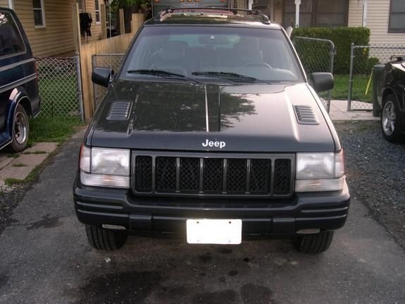

This issue was discussed at nauseam on my old Jeep ZJ forum, where the 5.2L and especially the 5.9L suffered from crazy underhood temps. It seems the best solution for that truck was the factory 5.9's hood vents:
There was quite the discussion about negative pressure at low speeds and all kinds of other stuff that's hard to measure, but the general consensus was that the Jeep engineers knew what was best and most went that route with their I6's and 5.2's.
