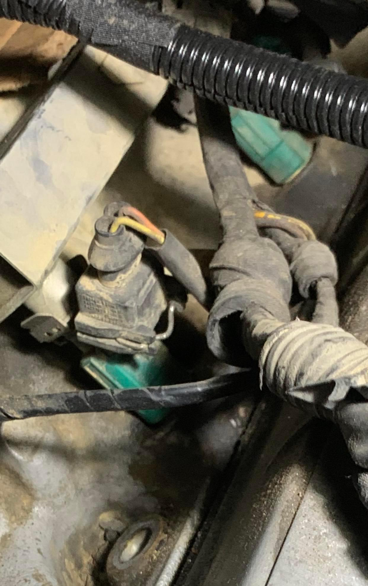

How do you remove and recondition the fuel injectors? Just pull them? Is reconditioning simply fitting new o rings? The injectors were twisting as I was removing the electrical connectors and I’ll spray those with contact cleaner. I had a misfire and I’ve read that sometimes it’s an o ring. I’ve found less expensive sets from Britpart and Elring, but I don’t know if they’re good. Hopefully they’d be better than the old ones though.

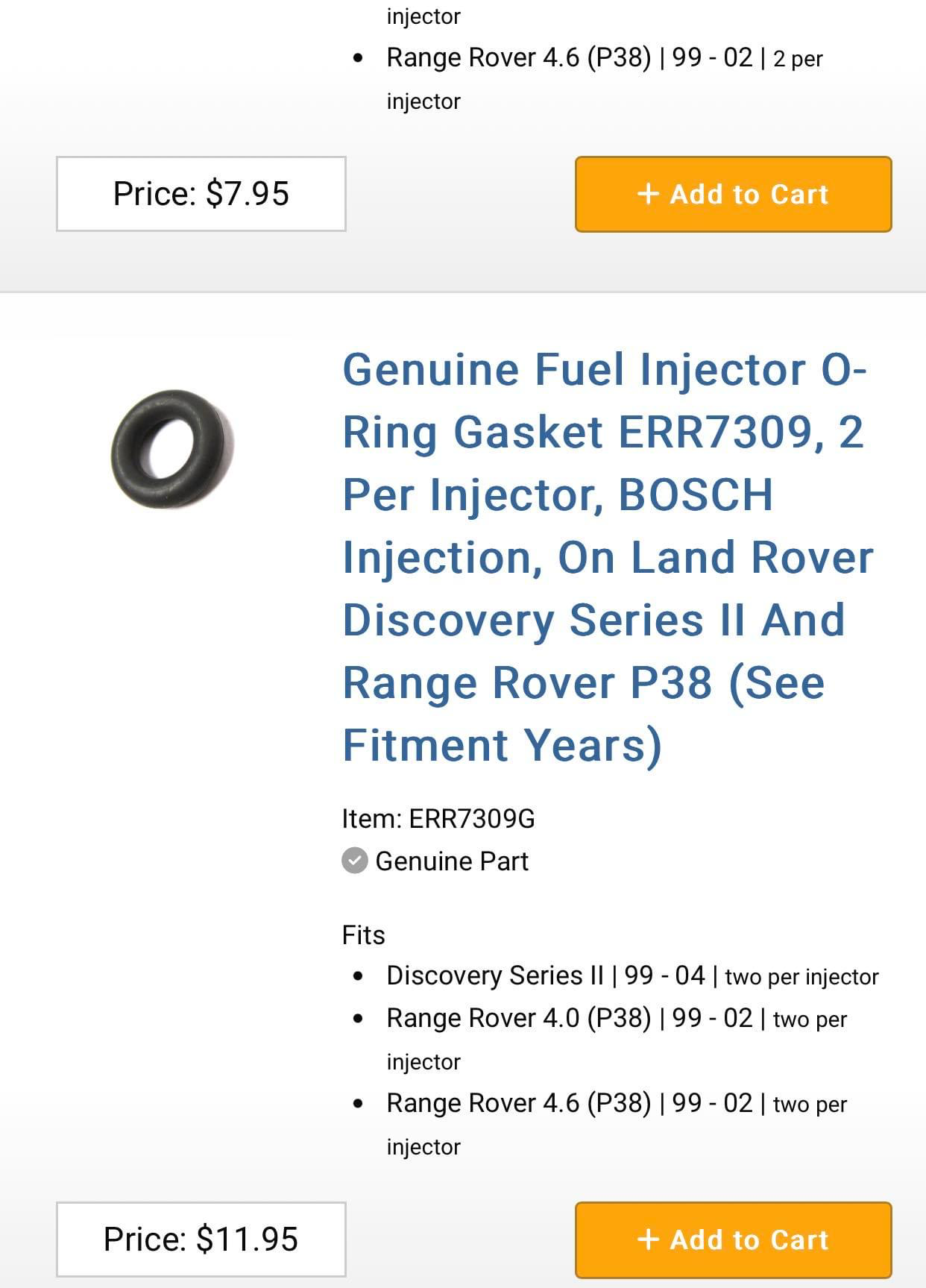

I know I’ll get further down and have to decide if I should also redo the heads - haven’t done any of this before so it’s a challenge. That injector service would be good. The fuel rail needs to be removed and you can just twist and pull them out? I’d wondered if the non-genuine o rings are ok to use since the genuine ones are $11 each and you need two for each injector. A whole set on eBay of elring rings is $35. I was also seeing P0305 (cyl 5 misfire), P1451 (evap?) and P0141 (o2 sensor?). They were all infrequent other than the cylinder 5 misfire code that would return before completing a drive cycle most of the time. I’ll have to see what I get when it’s running again, but I don’t like the thought of having to do a lot of this again if I don’t deal with those injectors/o rings now or possibly even the head gaskets…
