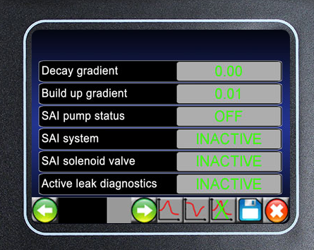

I’ve got a 2003 Disco with SAI. If I put in a new non-SAI ECU, could I uninstall all the SAI pump and junk?
(can a nanocom evolution turn off SAI functionality on the current ECU?)

A Nanocom can not turn off SAI. It only shows status of SAI system and parts...
