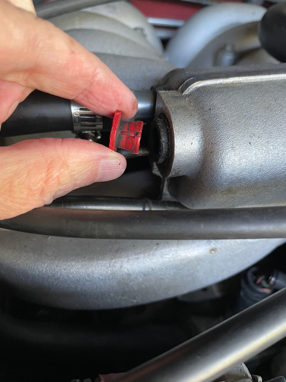

Hey mollusc, your statement is curious. The red ring comes out of the fitting quite readily on my truck. Always has. I've also grabbed a couple as spares from local boneyard trucks. Same situation; they came out easily.

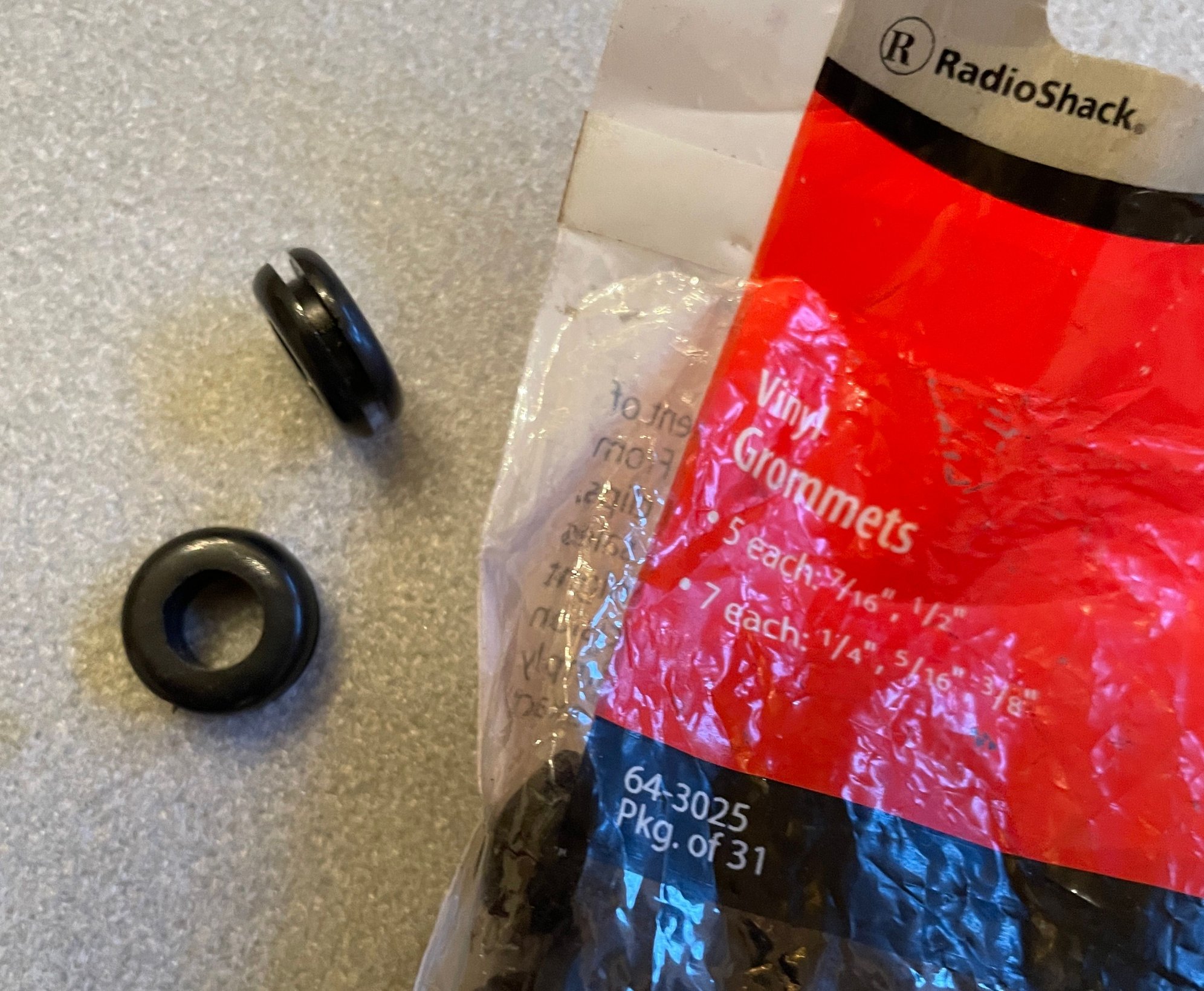

When I broke the red ring on my truck 15 years ago, I did a field repair by splitting a nylon grommet I had on hand using a razor blade (like the ones pictured, as close to one side as possible) and substituted it for the red ring. It sealed perfectly for a couple years at least, until I found a replacement red ring on a boneyard truck. I've also read a few accounts here of people removing the red ring and sealing the vac pipe in the fitting with RTV. You could try that as a interim solution.
If you remove the red ring and it looks okay, that indicates the problem is likely with the main body of the fitting. Given that, I'd replace the whole thing (LZN100220L). You likely know this, but to remove the vac pipe from the fitting push IN on the red ring while pulling the vac pipe OUT. (I wish I'd known that 15 years ago.) The red ring should then come out easily.

No. It's simply as shown in my pic.
