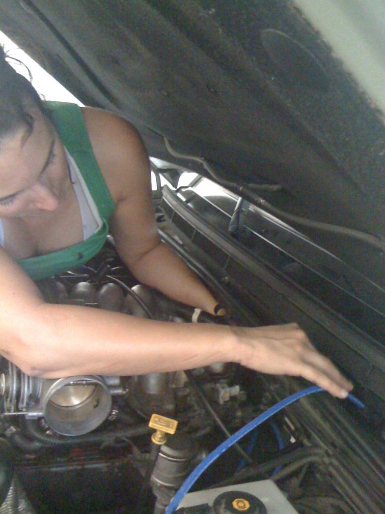

Thanks to the very detailed directions, this was a relatively simple job. That last wiring diagram helped tremendously. I think removing that SAI tube from against the firewall is the worst part of all.
I used Magnacor wires and was a bit worried about reading some people saying they don't fit right. I did feel the positive click then they were inserted into the coil pack. I had my helper assist me in this project because her hands are much smaller than mine. I must say that it's really not to difficult for a woman's small hands to do the job! She snapped them in quickly! Only downside is that it cost me almost $400 for the wife's assistance (a new purse...), but we had a great time together!
Thanks all for the instructions and comments as this would have been a big pain without them to figure all of this out.
