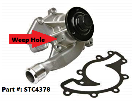

Check to see if the weep hole in the water pump is leaking.
Leaks from there can be constant or intermittent, and the coolant can end up in the area you are talking about.
And as red said pics will help. GOOD LUCK!

Thanks folks, pictures awaiting mod approval. I'll check out the water pump
