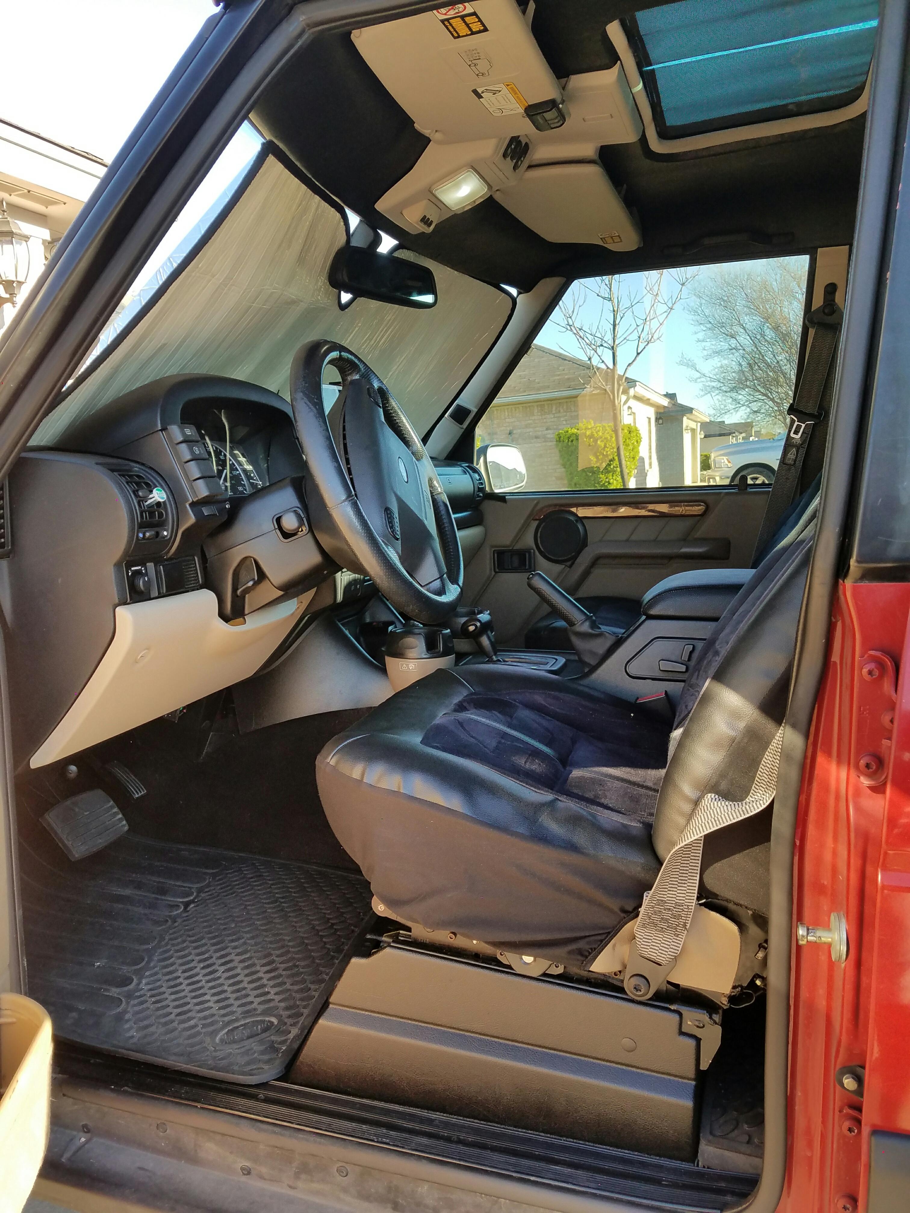

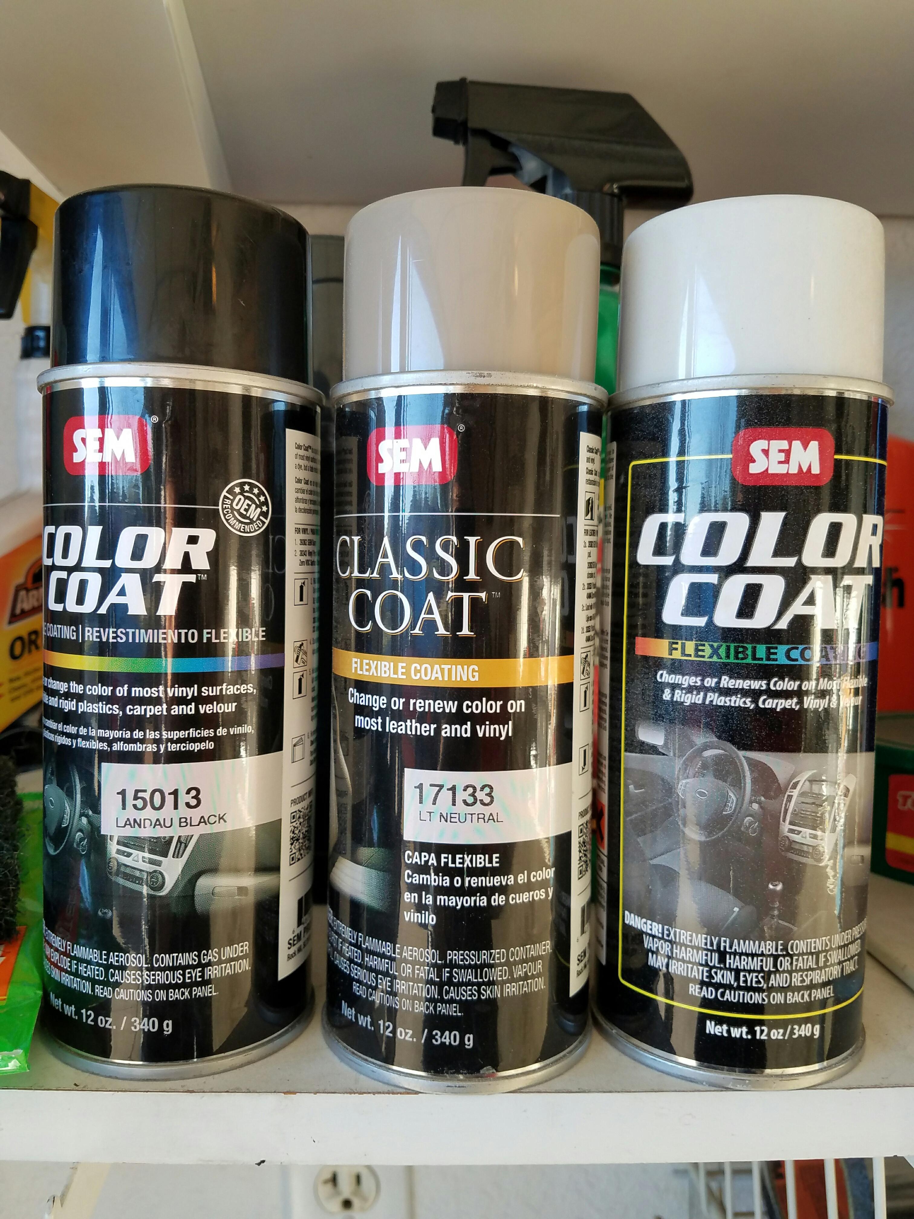

I agree with some of these last comments. Grease and wax remover as a prep. And avoid dupli-color interior paint, it's garbage compared to SEM. I transformed almost my whole interior from the D1 sand to the 03/04 black and gray/white.
Ps. Use a white base with lt neutral to match the gray/ white color.
Pss. Ignore my window covers. Texas heat is a B**** with all these windows.
