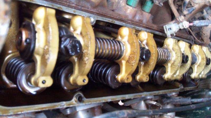

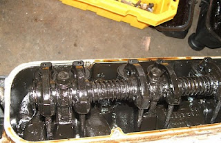

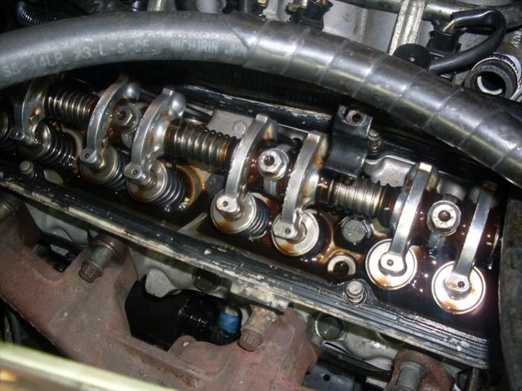

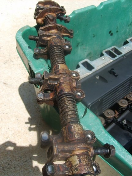

What manner of misery takes you into only one valve cover? Oil leaks are usually solved with snug up with the 8mm 12 point skinny socket. But while VC is off, consider using a stiff wire or rod to push down thru the gravity drain oil galleys. Here is what you may find. Hopefully no cracked rocker arms, etc. Also consider clean out of the PCV system.

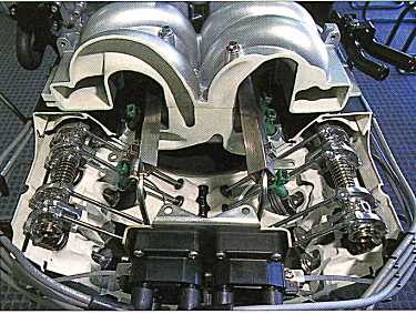

Understood. This is the other way to get at those wires, take a big band saw and slice away the offending firewall. Your way is faster.
