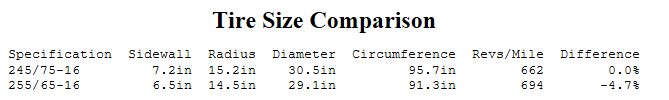

So it would be equally a non issue if i were to use a 255/65R16 for a spare when I get new tires which will be 245/75R16?
I'll probably eventually buy a new spare but in the mean time I won't kill my Tcase if I had to actually use the spare?
That would definitely be an issue. You are talking roughly a 1.5" difference at that point.

Thanks, Erik... I'll buy 5.
