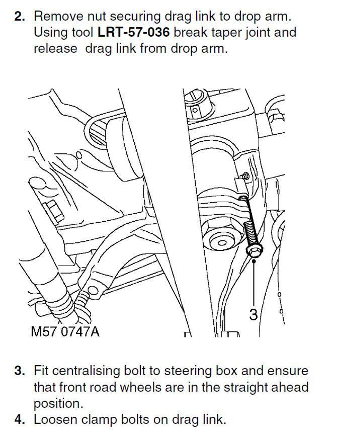

No to the track rod and tie rod end, but be very careful of the torque the RAVE is screwed up in one place refer to paged 57-47 through 57-49 for the correct value 59 ft/lbs
Get greaseble if possible and you will need an alignment after.
Rent the separating tool it makes dead simple to do

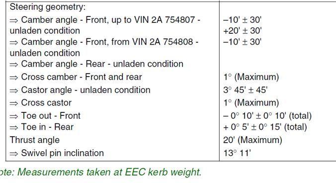

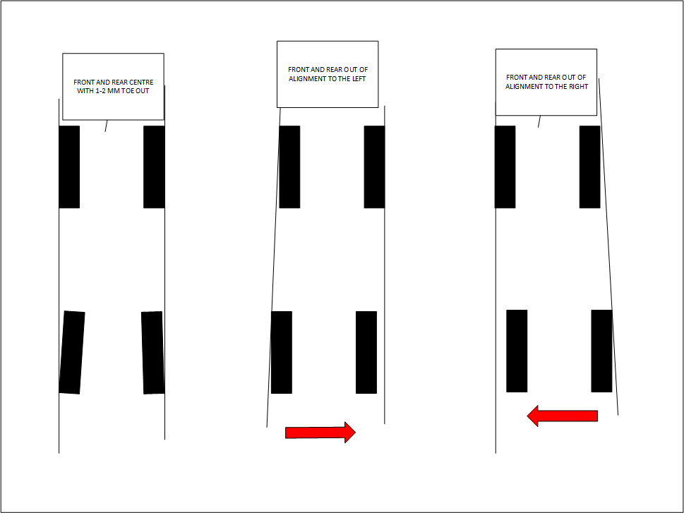

Dont forget to get your wheels balanced, one lost weight can make the front wobble, plus you can string line your wheel to puta basic tracking on before you drive it, you must check the drag link side first then the other side other tie bar,

@deodra Sorry about that the no was for no there are no other major things to doing the track rod and drag link, And yes to the separator jaws, I was typing between getting my honey do book done

Hi if your still not sure if your steering is centred then centre the steering wheel the get underneath, and check the steering box is centre correctly
if the steering box is centre correctly, then a string line across the centre of the rear tyre across the front pulled tight across the centre of the front should tell you if the alignment is of the wheels are equal, as per my earlier post, if they are not equal
you will notice the front is TOE OUT, to Parallel, so once your happy your steering box is central, run the string down the passenger side first to check the drag link is set up correctly, if it is now check the drivers side to see if the tie bar is set up correctly, if this is all OK then any gap at the back of the front wheels should be equal 1 -2 mm, to zero, as shown in my earlier post, finally check to see if your steering wheel in still centred
