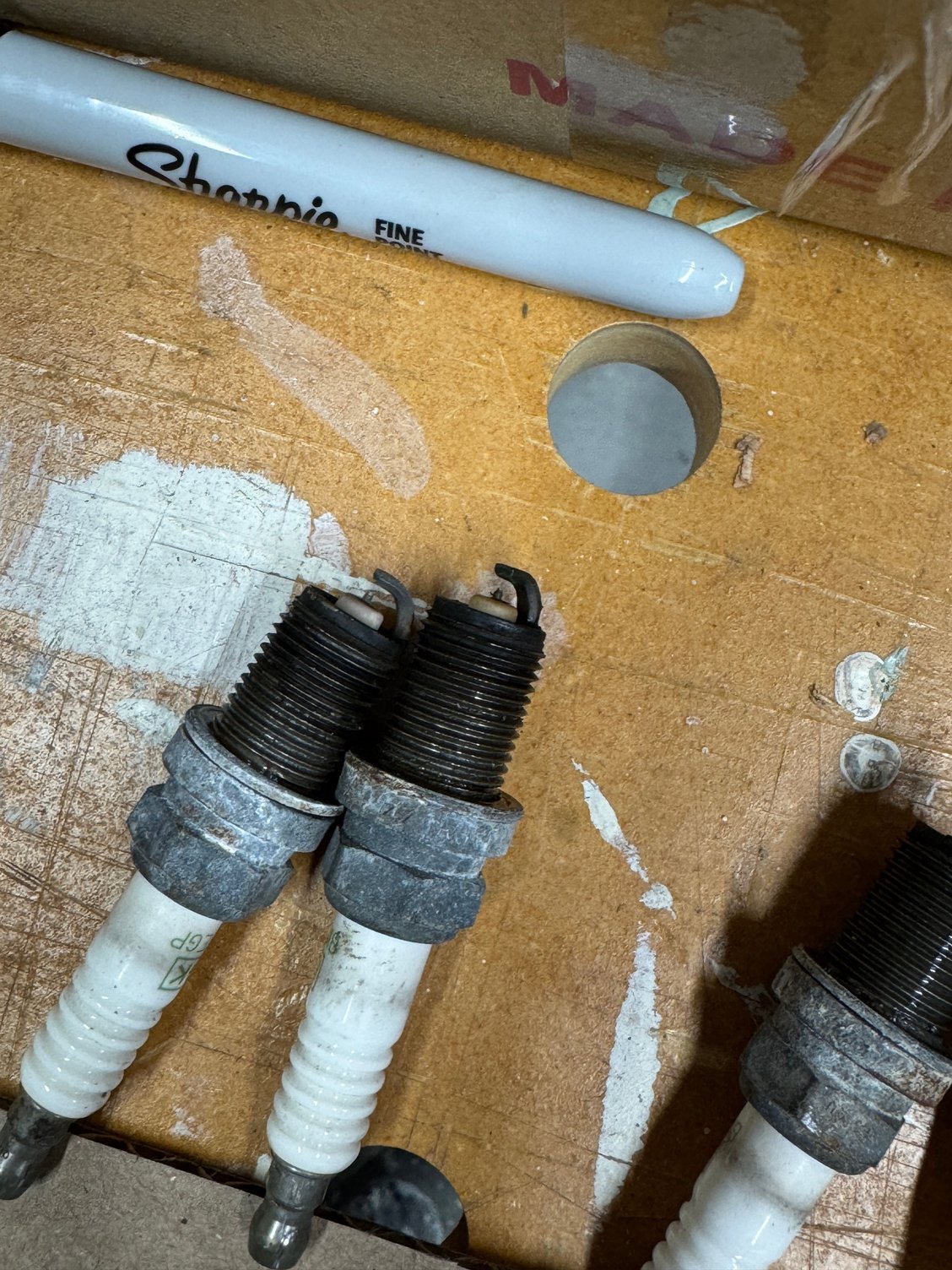

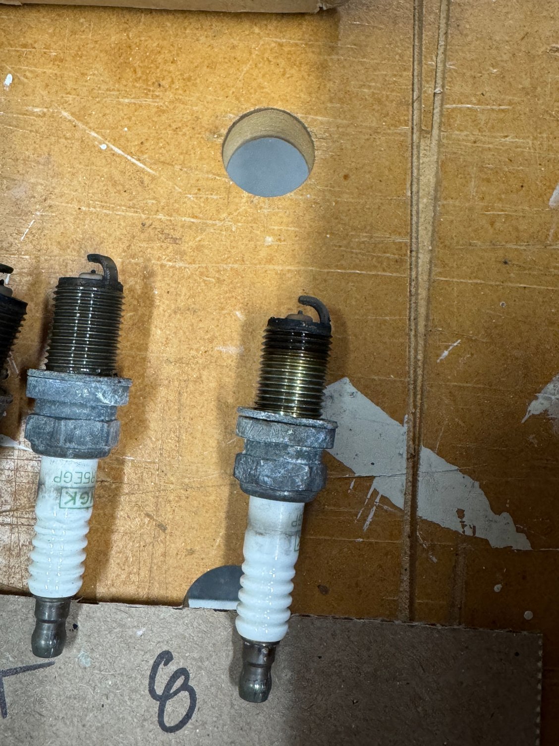

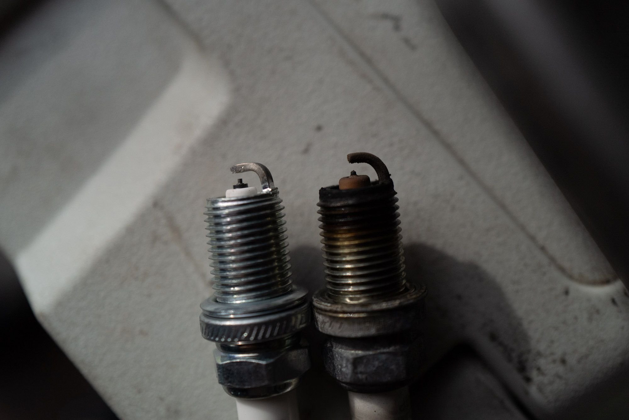

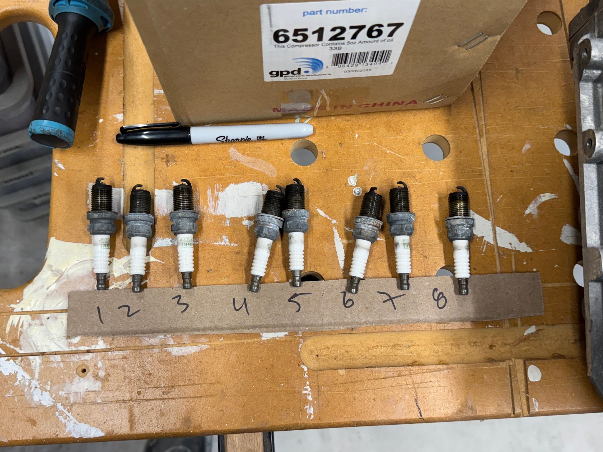

I hate to admit this because it feels so newbie, but I pulled the spark plugs yesterday and feel like this might be the problem. I replaced them in 2019, and about 80K miles ago, but the ones I put in weren't double platinums. Only single, NGK, which according to the internet and NGK themselves, last about 30-40K miles. The electrode on cylinder 8 is also the more worn, which might explain some of the issue? I have Champion 7070s on the way today.

Good on you! Worn plugs makes way more sense than a leaky injector. Maybe due to differences in spark advance hot vs cold, or simply the air/fuel mixture (harder to jump the gap in lean mixture). Did you measure the worn gaps? Amazing how fast 80,000 miles go by.

Installed the new sparkies. They were much needed regardless of this issue.

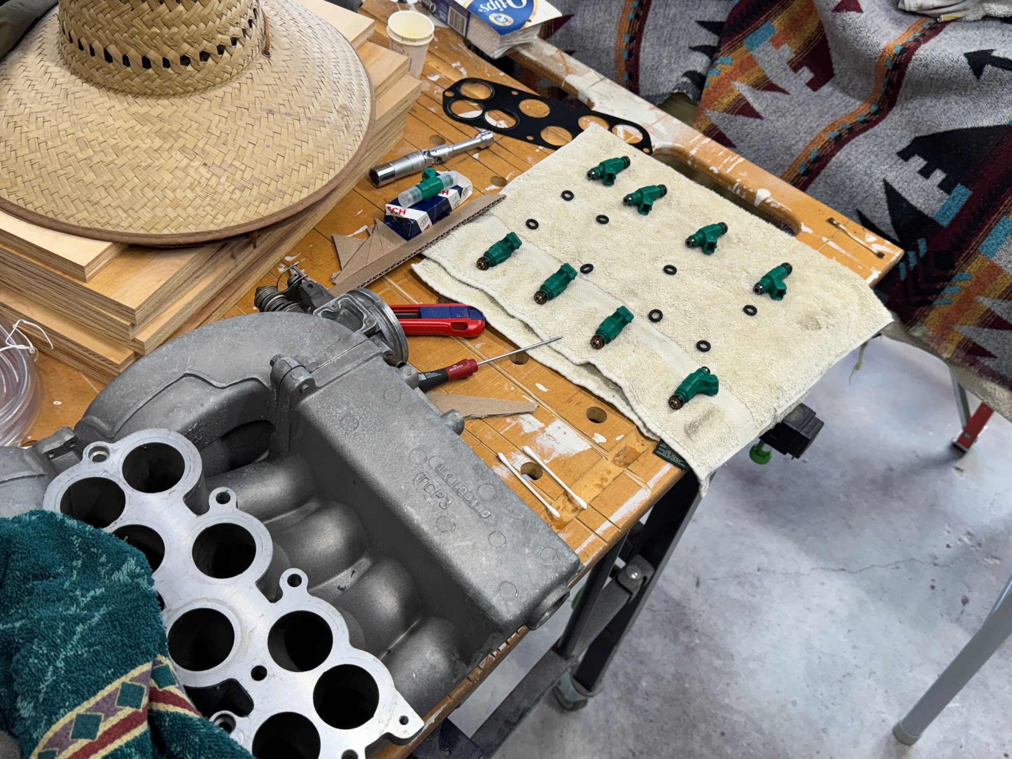

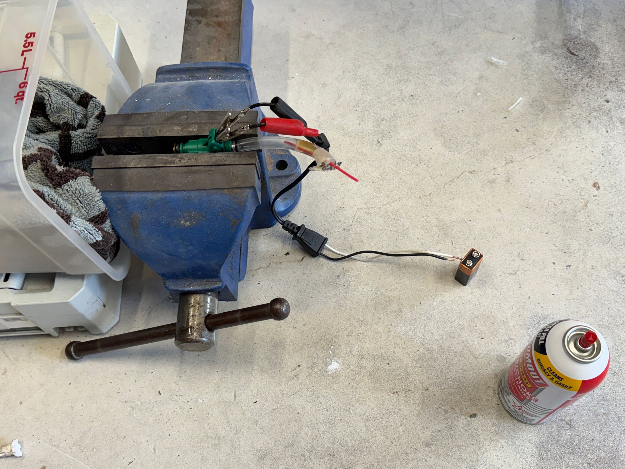

Also cleaned the fuel injectors while they were out. They didn't seem that dirty to begin with, but figured it couldn't hurt. Basically rigged up each injector to a 9V battery while spraying carb cleaner through a little jig I made.

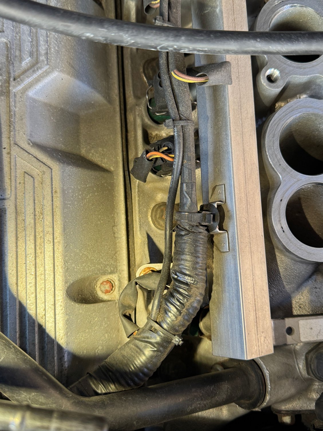

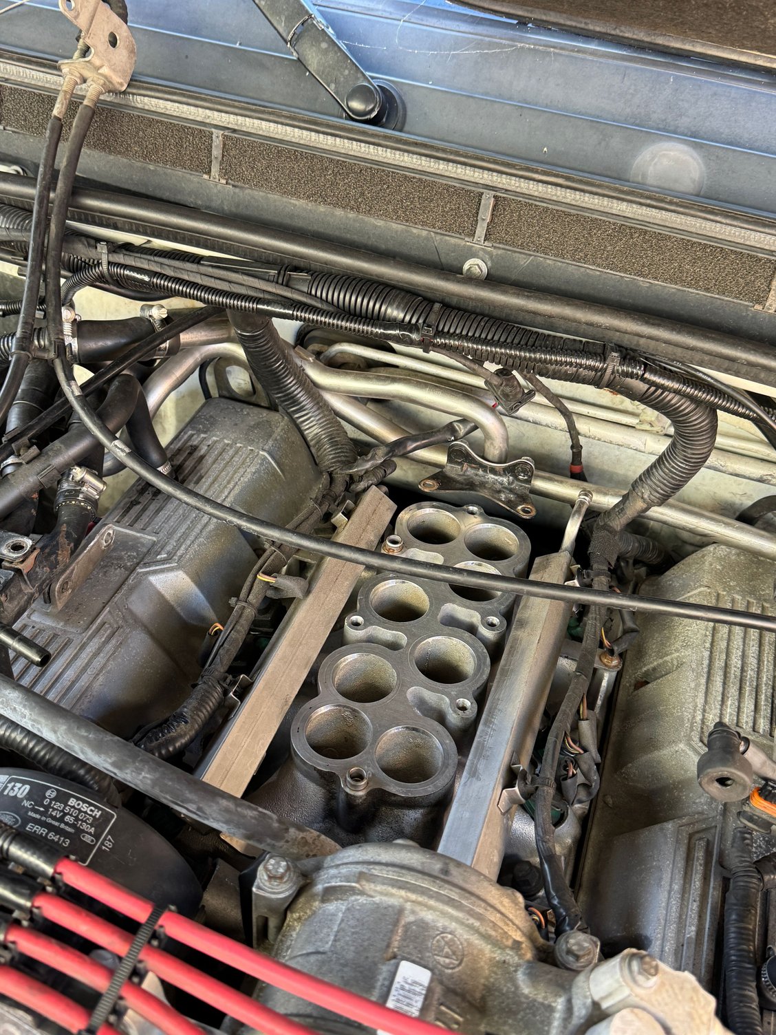

Another thing of note - while the upper intake was off, I noticed that the rocker cover gasket I installed in 2021 is pretty dry and shows cracks on the outside. Zero oil leaks, dry as a bone, but is this a possible issue? Possible vacuum leak?
Dry/cracking rocker cover gasket
