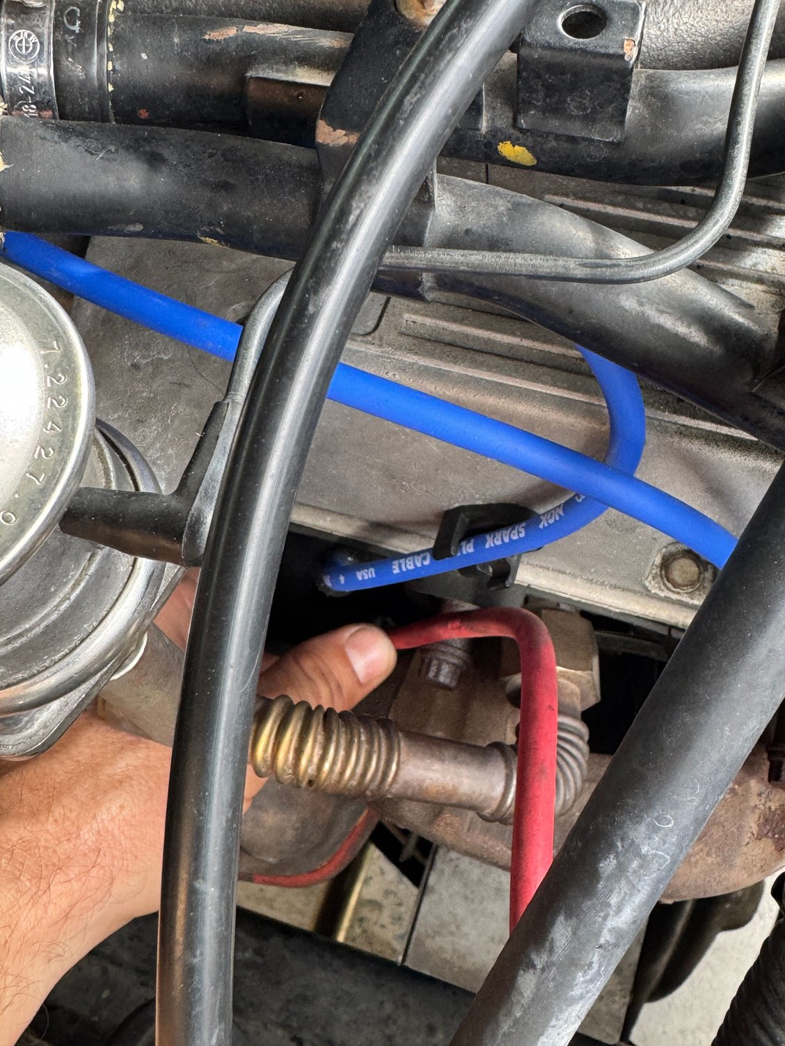

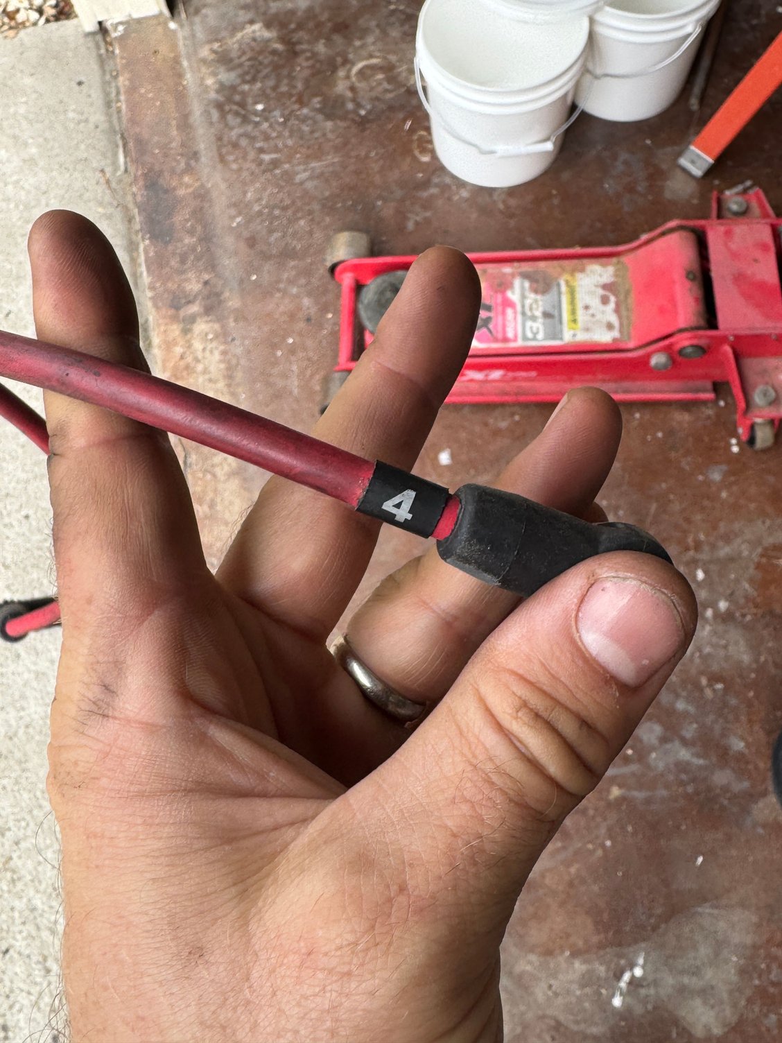

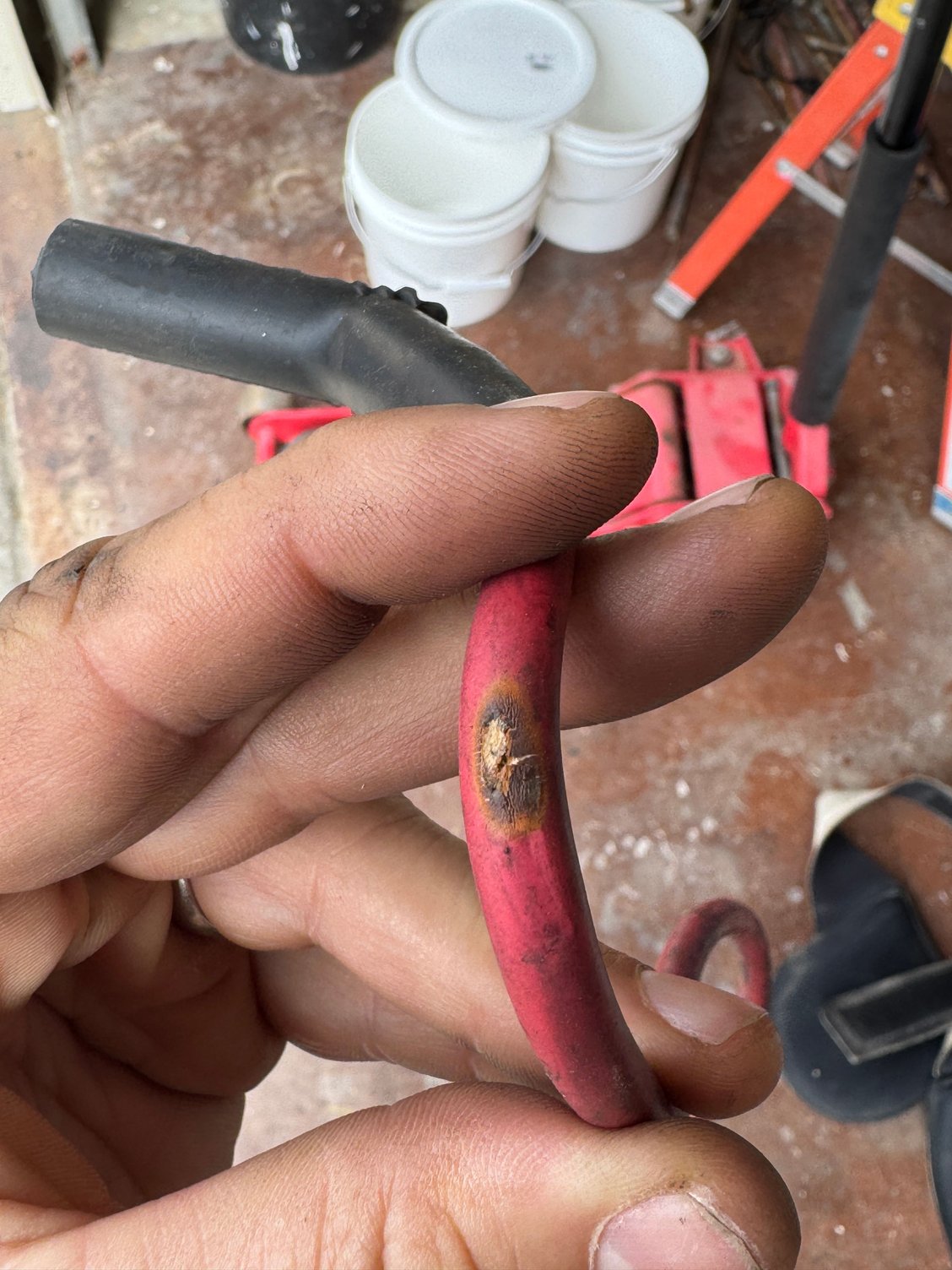

Problem solved. Wasn't a leaking injector, still glad I took them all out though to give them a good clean.
Culprit was discovered after installing the spark plug wire relocation kit from Extinct, which replaced a different style relocation kit. The way the #4 wire was routed for that system caused it to rub against the manifold bolts, eventually wearing away the shielding.
