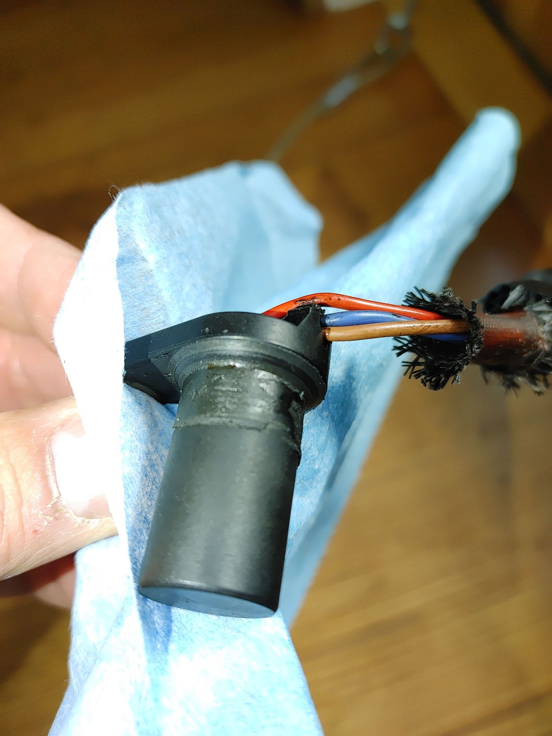

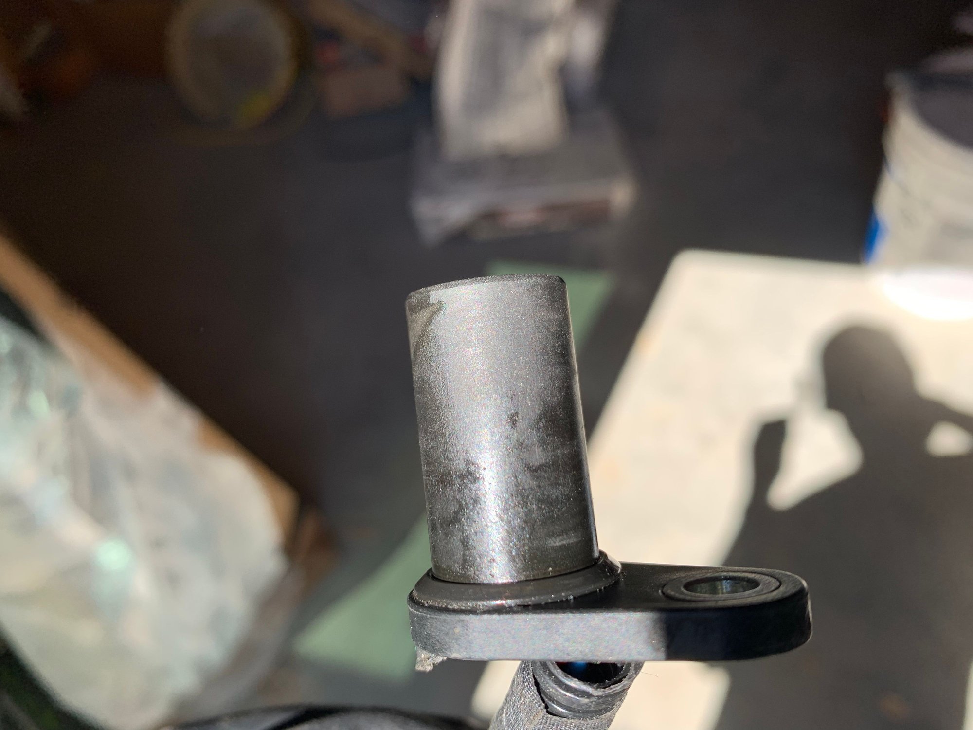

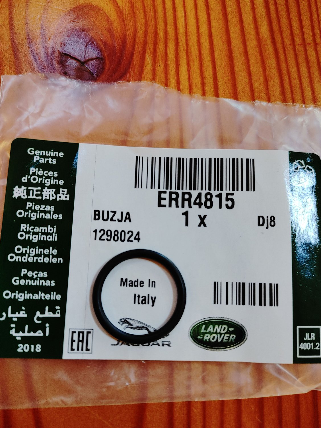

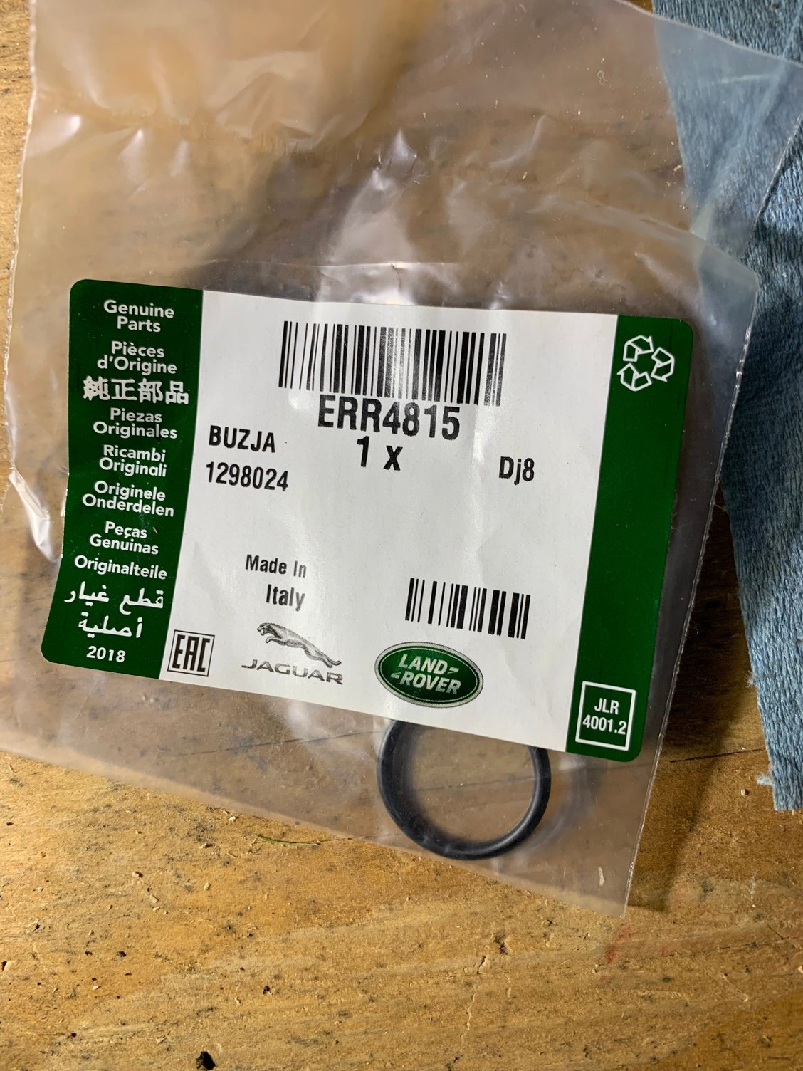

Hey folks, I am replacing the timing chain cover because of the usual: low oil pressure and lots of scoring in the oil pump. I have the new cover and am trying to install the old camshaft position sensor in it. I have a new o-ring (ERR4815), but it looks like the sensor itself has a kind of rubbery sleeve on 25% of the sensor on the wire side. Photos are attached. That rubbery sleeve is intact around the bevel, but is worn through and ragged on the shaft of the sensor itself. If that thing is worn, do I need a whole new sensor? I've been trying to look at photos of parts online but I don't even see that sleeve in the photos of replacement sensors I've found.
Anybody know anything about it? If I reassemble with that worn sleeve am I going to leak oil? Or does the o-ring do the whole job?
Thanks,
-- Jason
Look at that wear on the shaft
Worn all the way through

I would either clean everything up and glob RTV on the o-ring then see how it works, then replace sensor if still leaks; or just replace the sensor if I wanted to make sure I wouldn't need to do it a second time. The o-ring alone could leak since the sensor diameter is too small without the covering. Looks like that sensor has rattled around in there for quite a while.

Alright, thanks for that. I'm just going to put a new one in. I don't want to go back in there again. It'd really **** me off if it worked for a while then started leaking right after I thought the coast was clear.

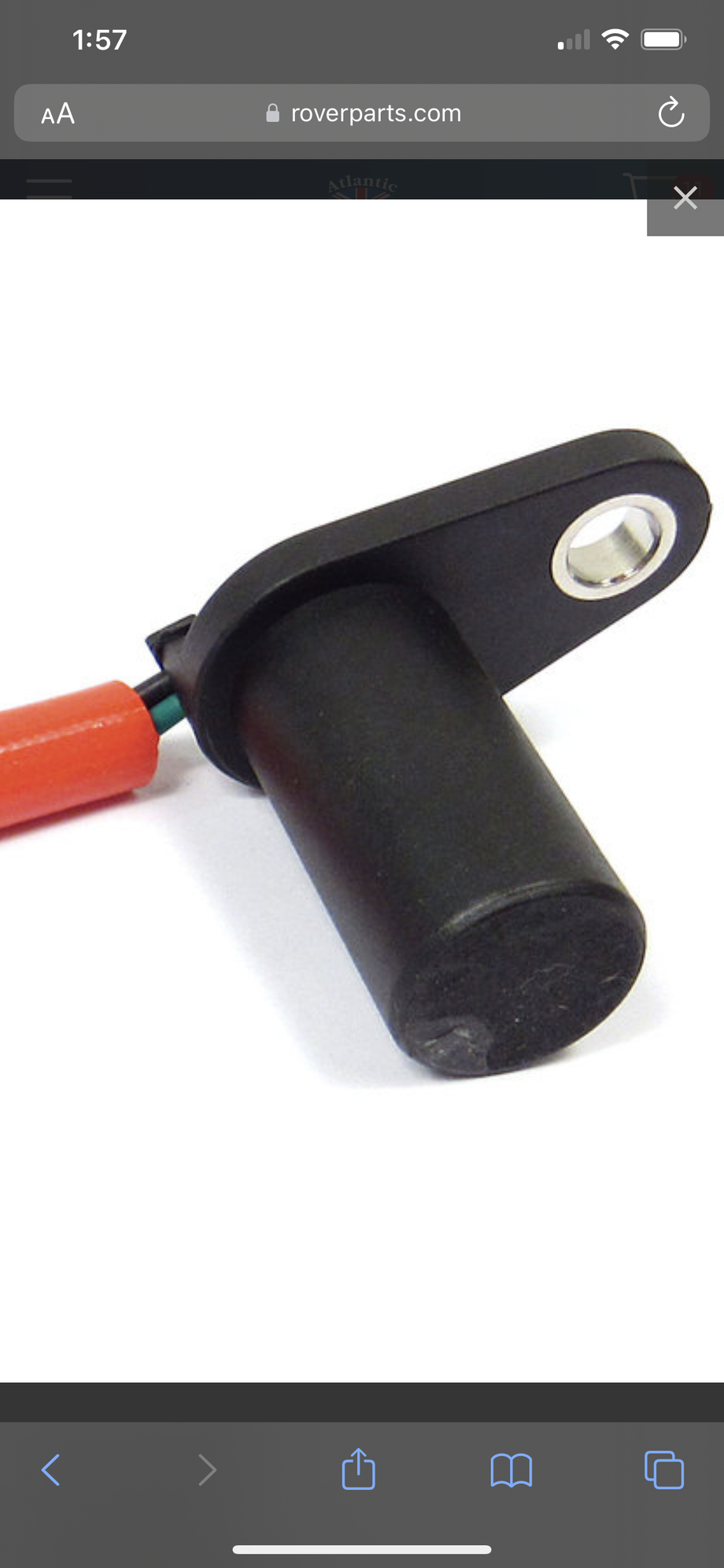

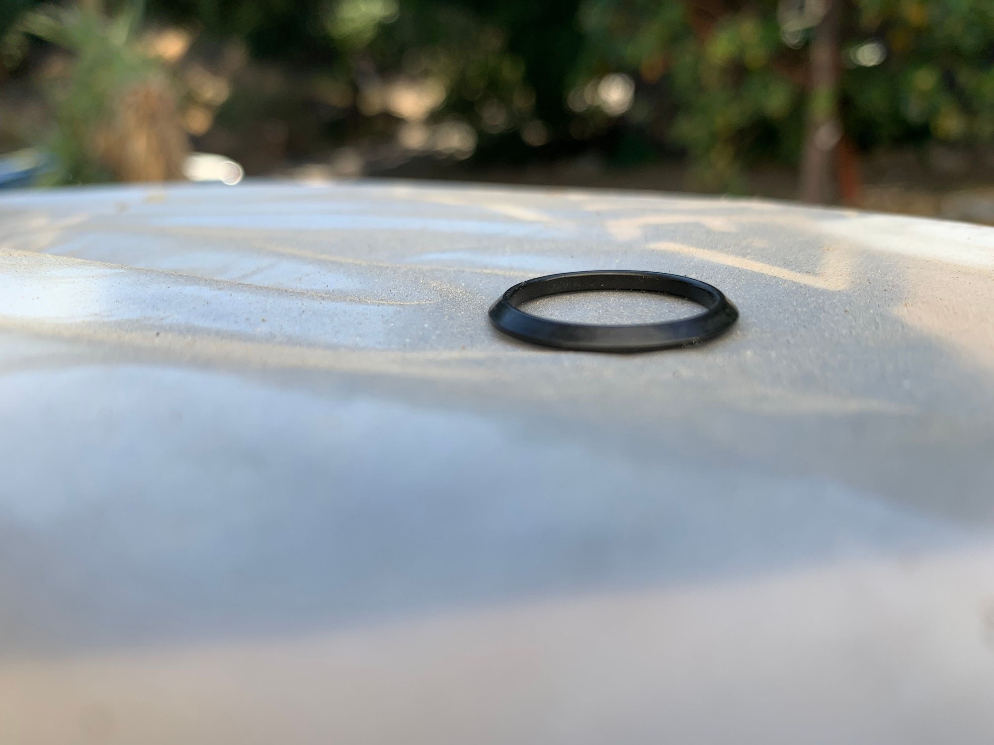

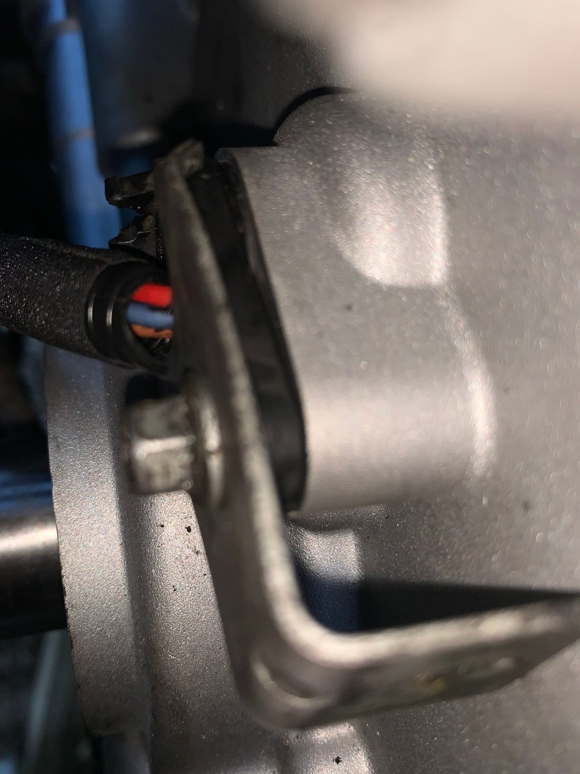

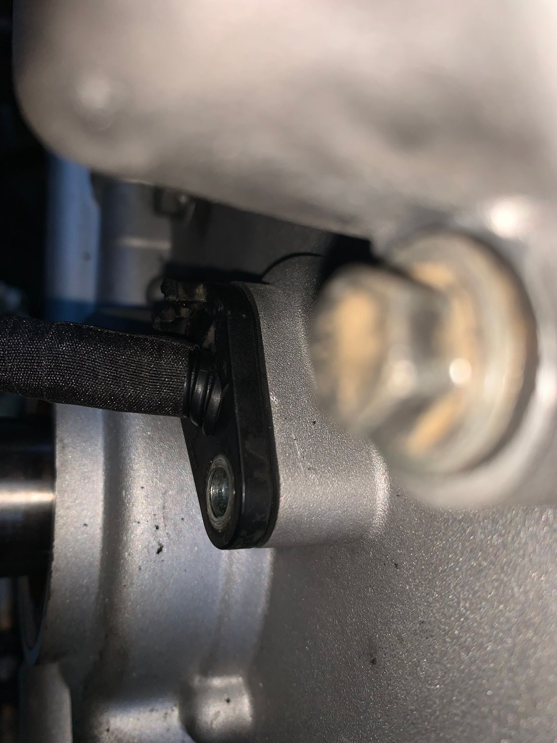

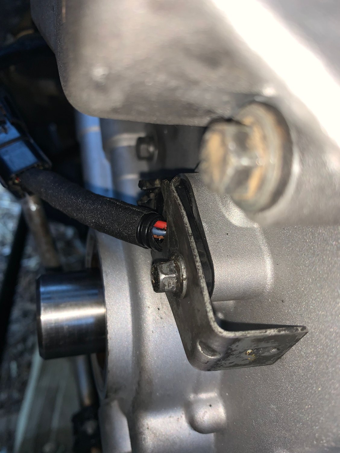

The issue I’m having is with the o ring preventing the sensor from fitting in properly. I tried lubricating the o ring but I’ll try lubricating the metal and twisting the sensor in.
This is without the o ring
With o ring
Doesn’t fit properly
AB sells this for camshaft sensor
Old Aug 8, 2023 | 06:29 PM
Extinct's Avatar
Posts: 5,309
Likes: 1,818
From: Lynchburg VA
Looks like it fits fine. The o-ring just fills the bevel. The sensor just goes in.

It turns out the original seal was still on there - it’s a rigid plastic that fits the bevel. I looked at a picture of the sensor on AB and found it didn’t have that bevel, so I realized it was a seal that could be removed. I figured the o ring probably seals better, so I used that instead of the old seal and it fit properly. Thanks everyone
