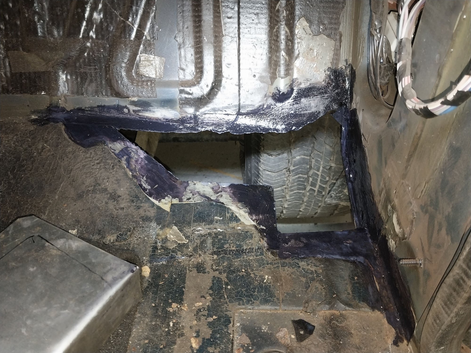

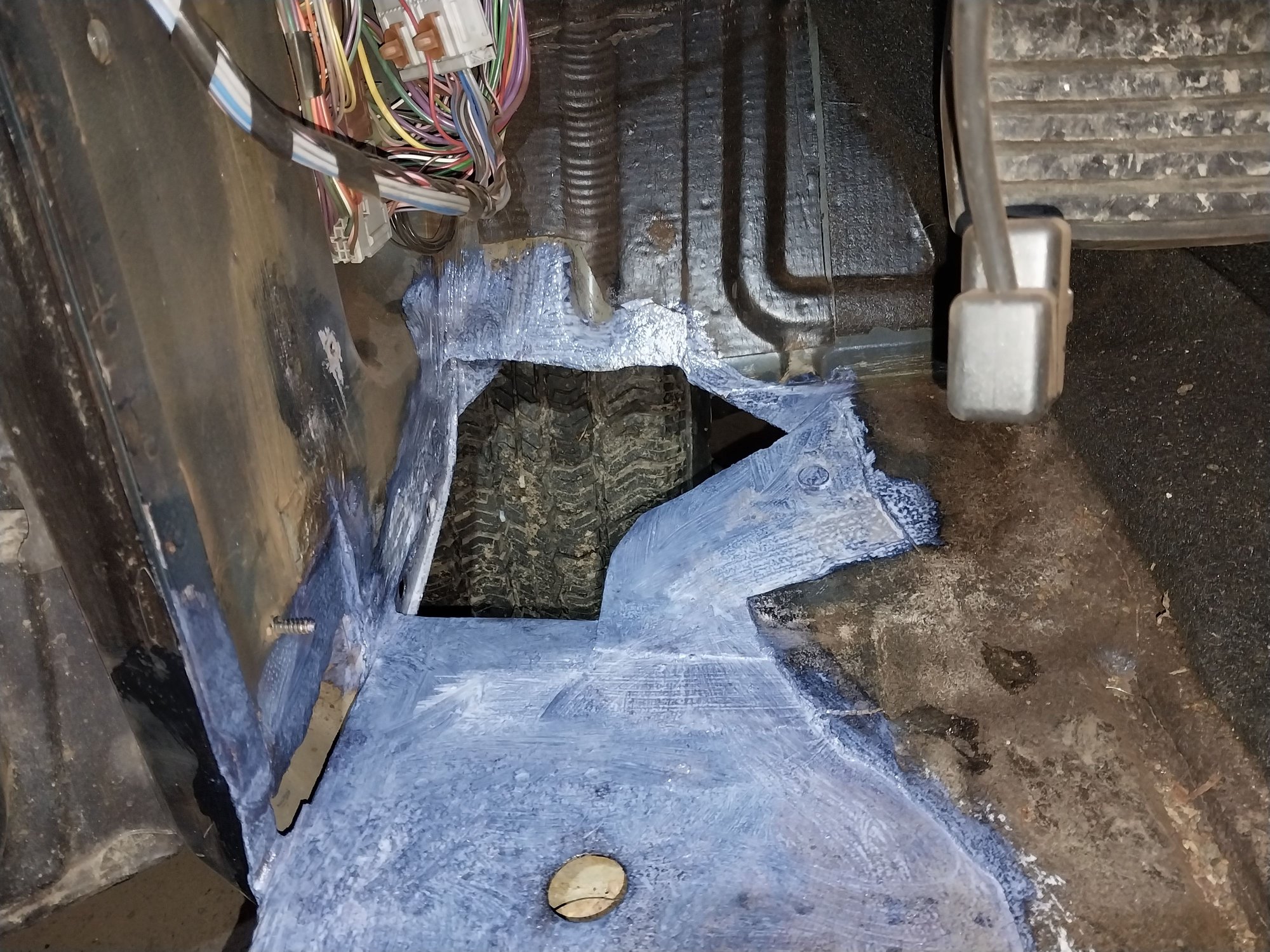

Old May 21, 2024 | 07:21 PM
nashvegas's Avatar
Joined: Oct 2007
Posts: 2,785
Likes: 1,993
From: Whidbey Island, PNW
Looks like a proper repair job btw. Good work.
Are you sure that rusted from the inside out? It looks like it may have been debris getting in the seams between the firewall and the fender (inner) from the outside and rock abrasion starting corrosion. Do they use salt in Alaska ? ie -- Maybe it just abraded / corroded from the outside in. How's the rest of the underside look?
If it was from inside out, usually the rusted areas are a bit lower (although that area gets it too).
Have you checked each rear outer seat belt anchor point. They go also... in a similar fashion from the underside in.

Thanks Nash.
No, I am not sure that it rusted from the inside out, but it appears that it did to me. The rust didn't look so bad from underneath, and there was not much undercoating missing. I found when I took out the interior and started cleaning that the rust was far worse than it looked like from underneath. The city started using a chemical treatment (salt) about 10 years ago. I would guess this rust started before that. Most of the underside looks pretty good.
I bought the truck around 8 years ago, I think. I was told it had been sitting for 2 years. It seems I might recall that a window or two were not up. Anyway, who know what happened to it before I got it.
I have not checked the seat belt anchor points, I'll do that when I get home. I got the patches in and painted, then I had to leave to go to work. When I get back I plan to apply some undercoat, then leave it sit outside. I'll let it get rained on without the interior in it so I can look for leaks.
I thought I took some pictures of the floors after I painted, but I can't find them on my phone so I guess not. I did get one with my patch sitting next to the hole.
