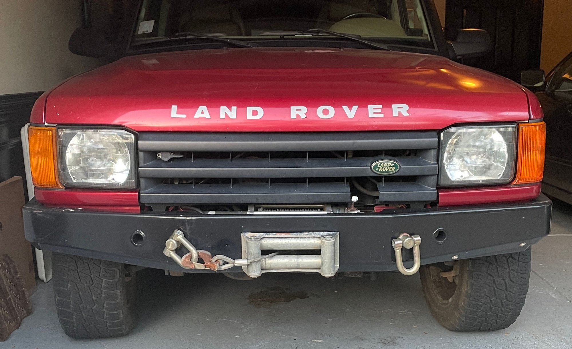

I'd love to see a pic if you have one handy.
Here's a pic taken this evening. While it’s true my ’99 has a grille from an ’04 installed, there is more to the story.
In mid-2015 I installed a Terra Firma front bumper. I found using my truck’s original grille would require trimming it substantially on the bottom. I was able to find a facelift grille at a local boneyard, cutting an opening in it as shown to accommodate the winch clutch lever.
That said, the ’04 grille does just drop right in. The two “pegs” on the bottom and all the holes along the top edge line up.
Originally Posted by jastutte
interesting. i have a grill from a 2001 that will not fit on my 2004. i believe it was too large, but it's been several weeks since i attempted it.
That makes sense, since the '99-'02 pre-facelift grilles are taller than the post-facelift, '03-'04s.
