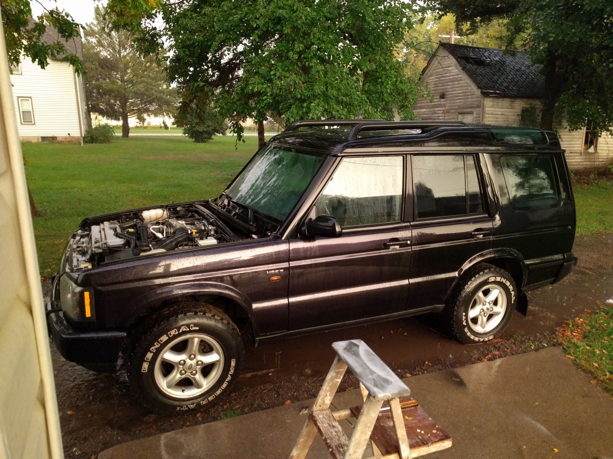

My 04 HSE was purchased after the PO installed a coil conversion and it looks new as in no rust. My problem is that it looks like it is squatting in the back and my measurements show a 2" difference from front to back (ground to fender). Maybe they bought a FUBAR kit.
The front coils are stock not 2" lifts. So my question is what is the fix?
I found 2" rear spacers for the springs from AB. $70
Also found several choices of new rear springs but I dont want any lift over normal height. $170

You are sure the fronts are stock?
Measure from center of wheel center cap to bottom edge of fender for accurate comparison and post the measurements.

Fender to center is 19 3/8" on front - 17 5/8" on back.
Is your arnott set the C-2203? I could probably use that.

I've got 19" in the front, but that's with the fender flares on.
