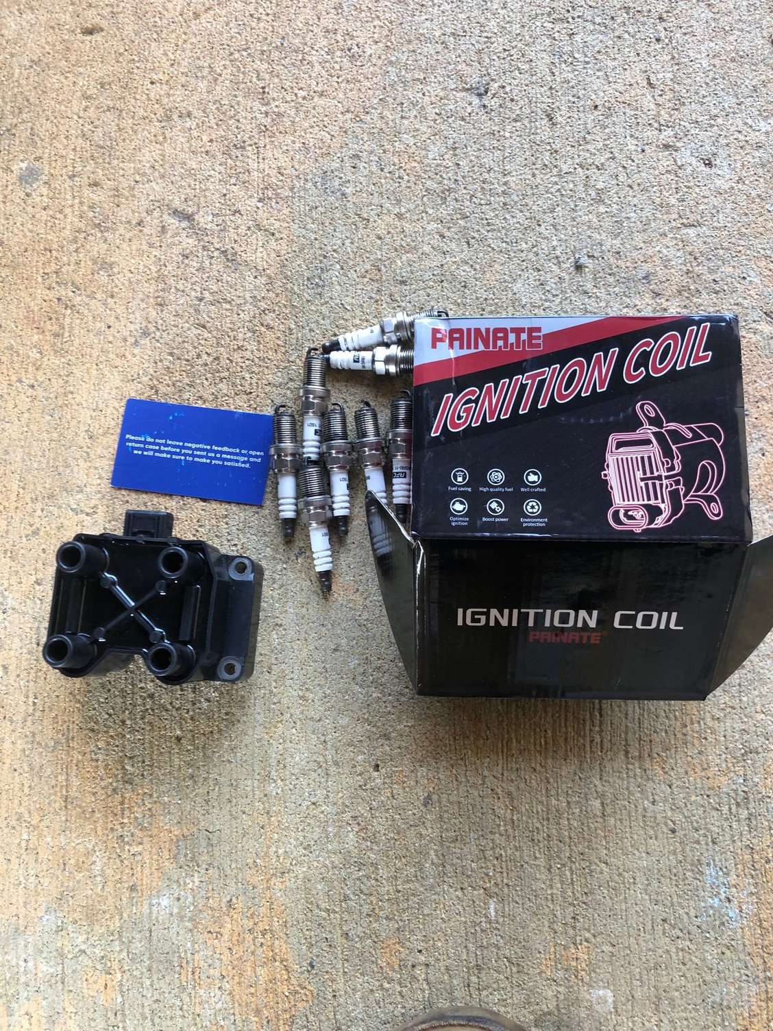

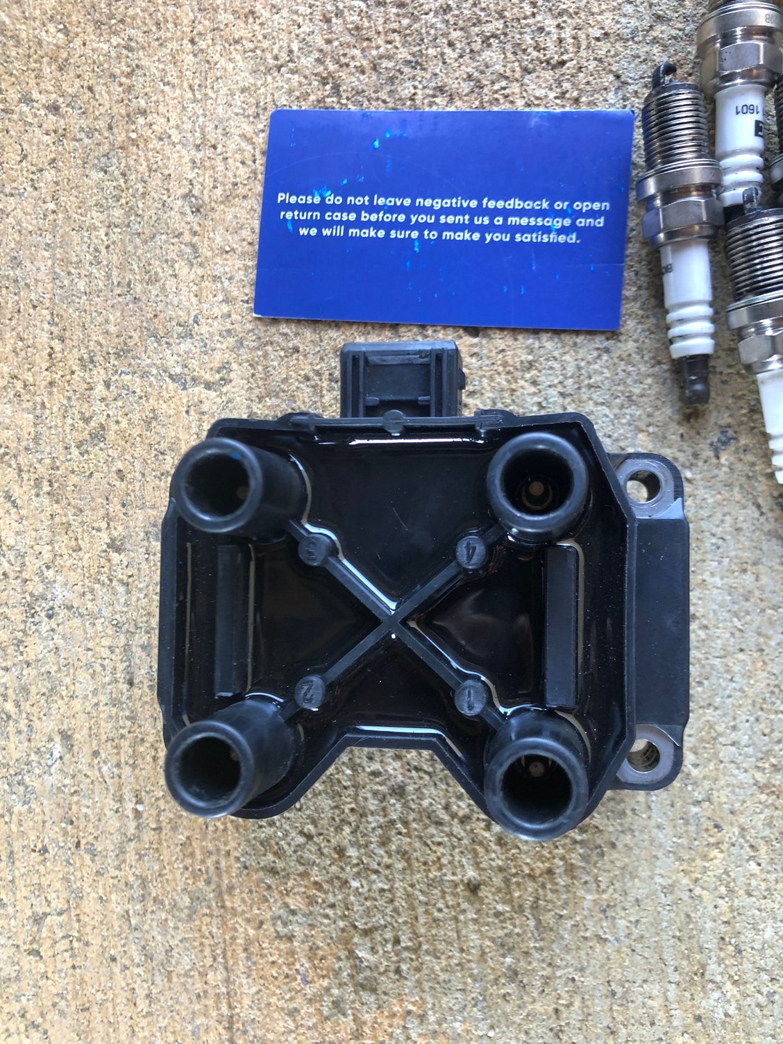

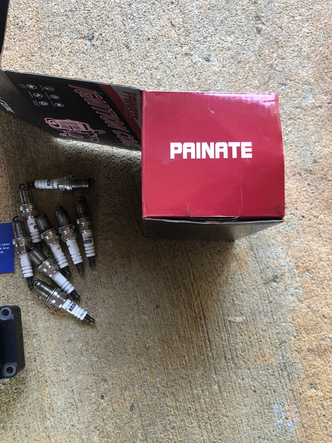

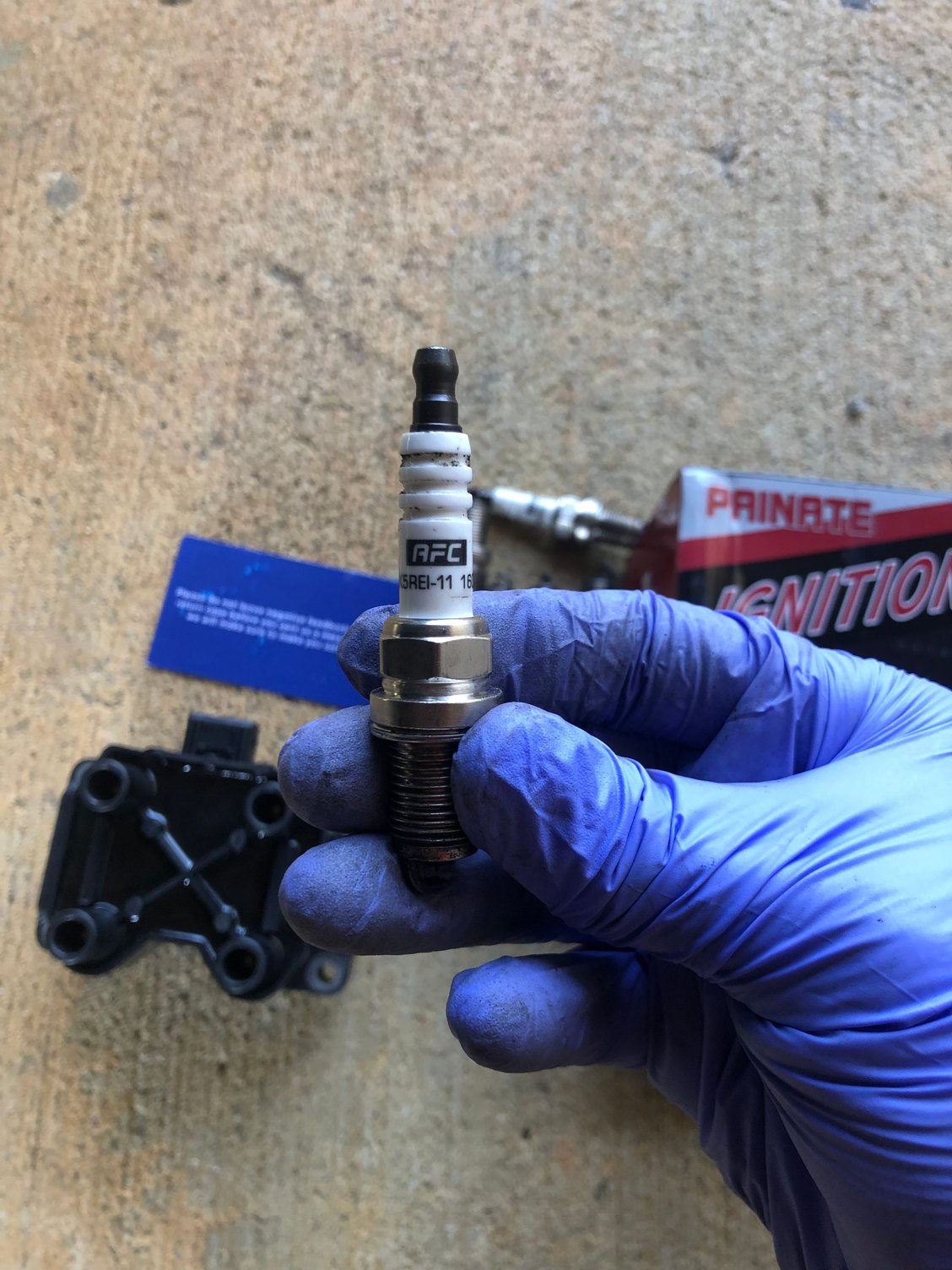

So here’s the great news: so I swapped back the old champion plugs and Bosch coils with the new oem Bosch wires I bought and bam ! Started up like nothing ever happened !!! The coils and plugs from god knows were almost blew up my rover ! Word of advice to whoever reads this just buy the oem parts the first time or end up tearing down the engine multiple times chasing misfires ! I learned my lesson for sure . Thank you guys so much !
Also these guys didn’t even send my wires that were suppose to come with the kit . The reason behind why I bought oem Bosch wires from local parts store . Just all around screwed me over big time ! Stay away from Reginald auto parts on eBay . Grab the oem if you’re going for parts or just locate a reputable seller like Atlantic British . I’m sure every one here knows but just a word of advice for newbies like my self !
