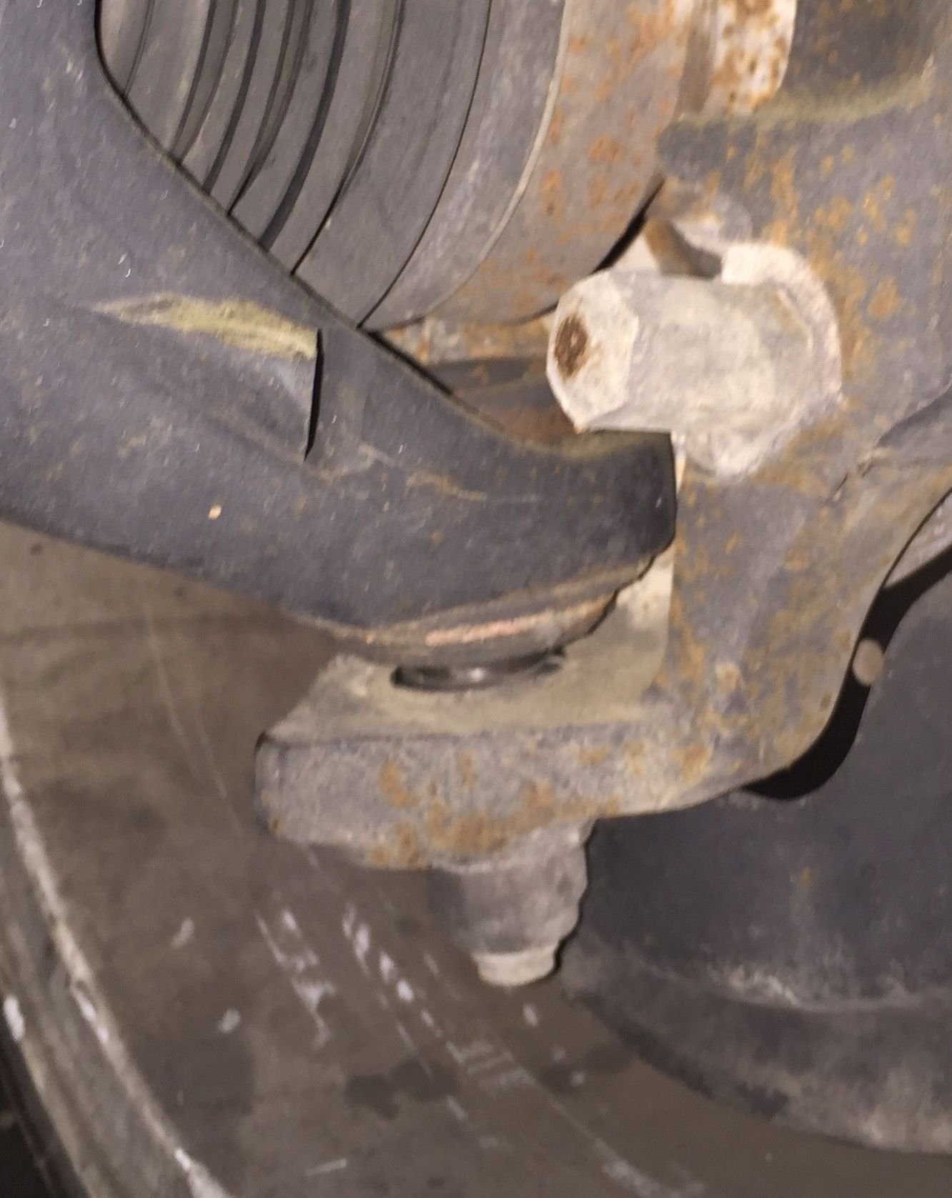

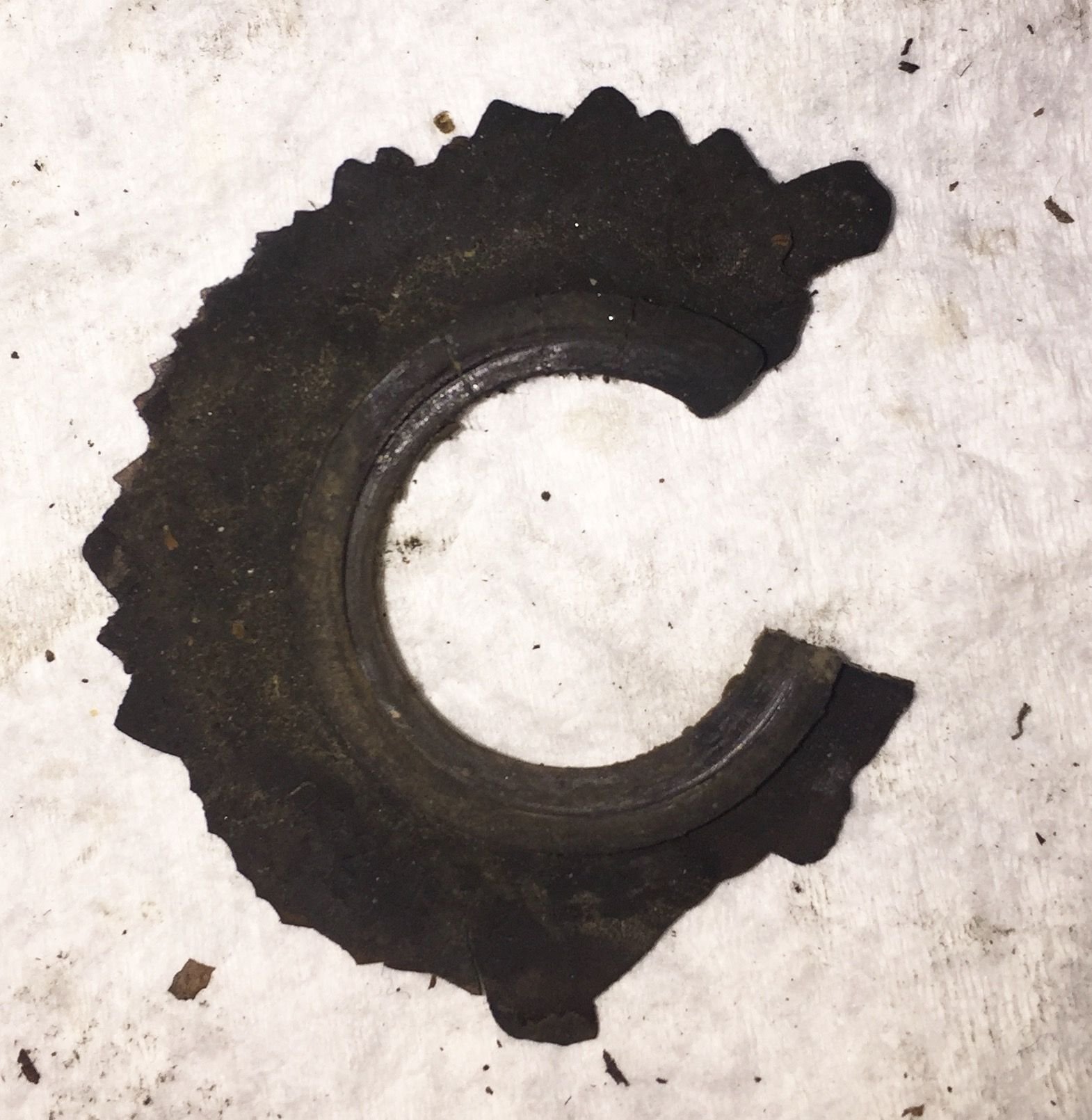

See the images, below. I was replacing motor mounts today and made the mistake of resting for a minute and looking around (this almost always results in more work). Noticed torn up rubber, which initially looked like a damaged boot, under both front axles/hubs. There is darn little online showing this part of an '03 Disco 2 in diagram form, but it seems to me this is a seal, rather than a boot. The second image is a loose piece that I pulled out.
So ... What's it called? Where do I get more? Must I pull the entire CV assembly to replace?
Thanks.
I pulled the damaged rubber piece from here.
Sure feels like a boot, but everything I'm reading says its a seal. Whatever it is, its shot.

That's your lower ball joint seal/boot. If I had to guess I'd say the other side is the same way and the uppers are on their way if they're not already.
Luckily ball joints are cheap-ish parts. Just replace all four while you're at it instead of making more work for yourself later.

X1 .............. That's the grease/protection boot. Replace all 4, an easy days work.
Never look around the D2 too much otherwise you'll find enough work for 24/7.

Yep ... that's what it is, alright! Just ordered upper and lower ball joints for both sides from AB for about $100. That and a $75 Ball Joint Service Kit from Harbor Freight should see me through this particular task. Whether the CV/Axles need to be replaced will add fun and mystery to the chore.
