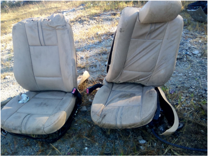

Visited the boneyard today. As good news; found an unknown BMW seat is nearly the same. Bad news... It was out of the vehicle, mangled and muddy, and found no other BMW at the yard to look for a donor of the same.

Hi. Reporting 'progress'
Canibalized a leather skin + sponge cushion from boneyard, seat had a label under :
As found at the yard, never saw the vehicle. The right one donor was deformed but not torn. Look grey but it is tan, not 'camel' color
Cleaned and installed. Am pleased. Nothing fancy nor extraordinary but works. The good part is the donor BMW seat can be driver or passenger ! ; they appear the same and more likely to find passenger ones in much better condition. Did not remove the whole Disco seat from the vehicle. It would had been a nightmare as supports are rusted.
Perhaps someone will appreciate the option. Enjoy.

Well I’ll be damned, it sorta fits. Is it secure on there? Looks like an E34 5 series?

Was very hard to try to fit the 'J' channels all around with my zero upholstery skills and tools; drilled a few points to the 'J' strips, added helping nylon ties taut to the seat frame. Goes firmly nowhere, no interference with seat motion. No clues on E34 - 5 series but label shows E83 ¿?
Ahh... $30
