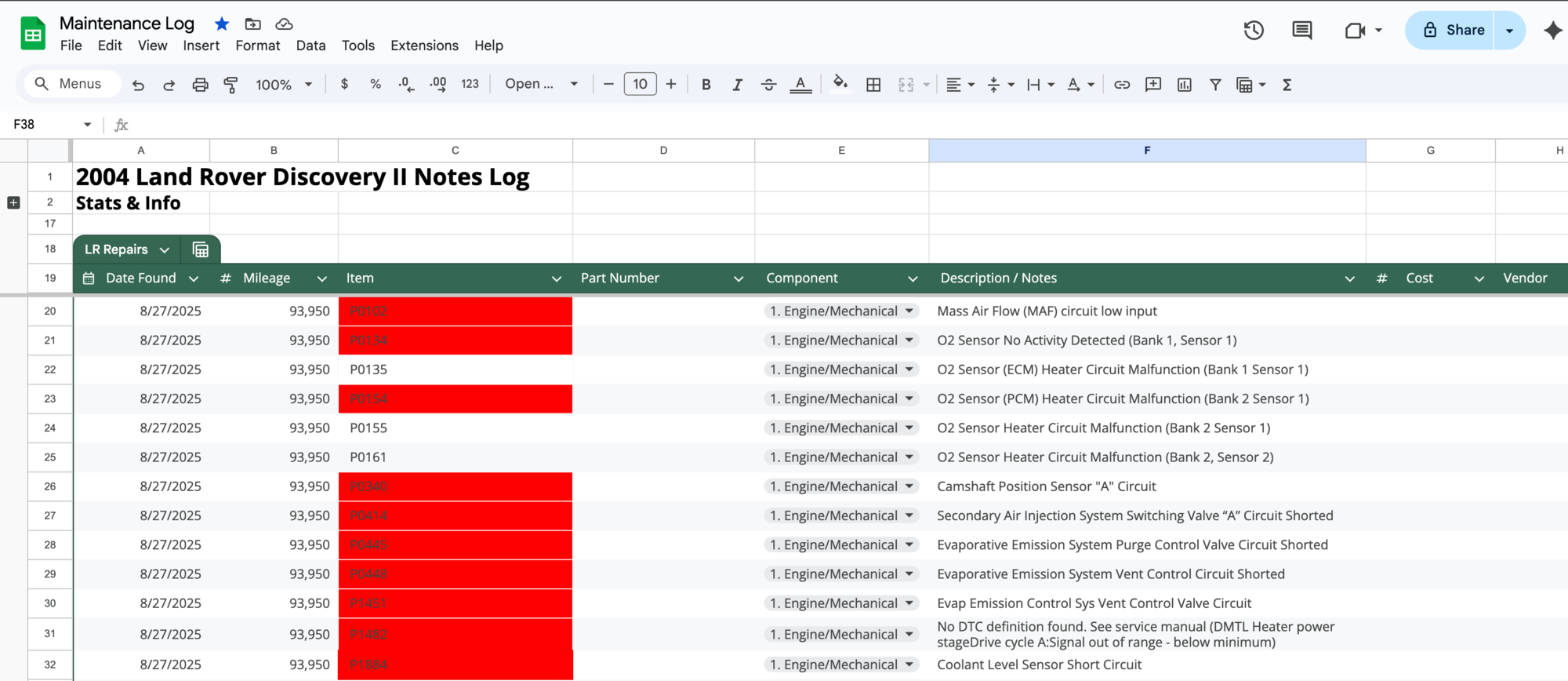

  • She restarted without hesitation, but was now showing SES. I keep a code reader in the center console, so I read the codes and was shown as many as 12 various codes, all related to O2 sensor malfunctions, MAF input, and various shorts:
    • P0102: Mass Air Flow (MAF) circuit low input
    • P0134: O2 Sensor No Activity Detected (Bank 1, Sensor 1)
    • P0135: O2 Sensor (ECM) Heater Circuit Malfunction (Bank 1 Sensor 1)
    • P0154: O2 Sensor (PCM) Heater Circuit Malfunction (Bank 2 Sensor 1)
    • P0155: O2 Sensor Heater Circuit Malfunction (Bank 2 Sensor 1)
    • P0161: O2 Sensor Heater Circuit Malfunction (Bank 2, Sensor 2)
    • P0340: Camshaft Position Sensor "A" Circuit
    • P0414: Secondary Air Injection System Switching Valve “A” Circuit Shorted
    • P0445: Evaporative Emission System Purge Control Valve Circuit Shorted
    • P0448: Evaporative Emission System Vent Control Circuit Shorted
    • P1451: Evap Emission Control Sys Vent Control Valve Circuit
    • P1482: No DTC definition found. See service manual (DMTL Heater power stageDrive cycle A:Signal out of range - below minimum)
    • P1884: Coolant Level Sensor Short Circuit

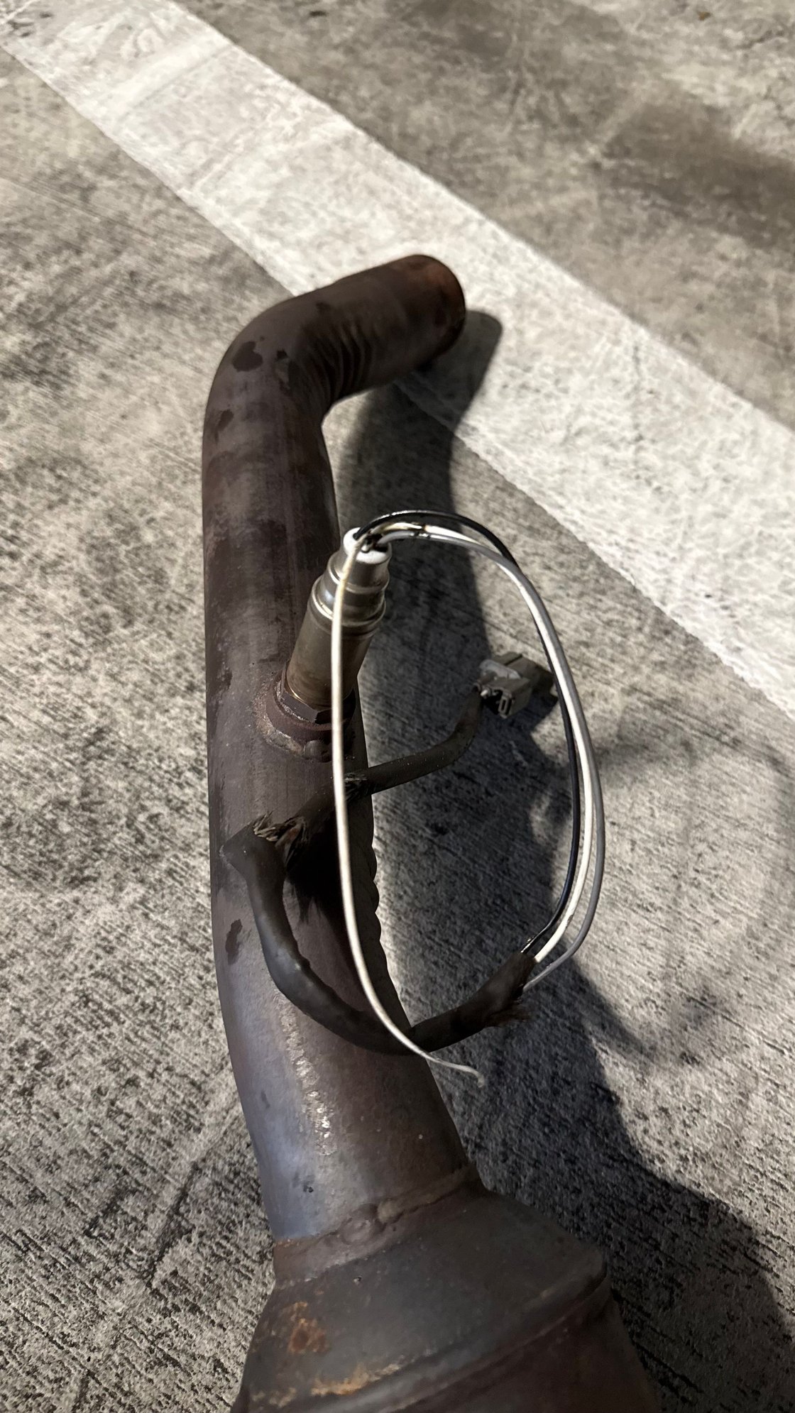

  • After some research, some others have discovered that this behavior can be due to an issue with the lambda sensor wire melting or shorting somehow. I crawled under the truck to discover that I hadn't routed the bank 2 sensor 2 (downstream of cat) wire correctly, it got wrapped around the propshaft, and broke off

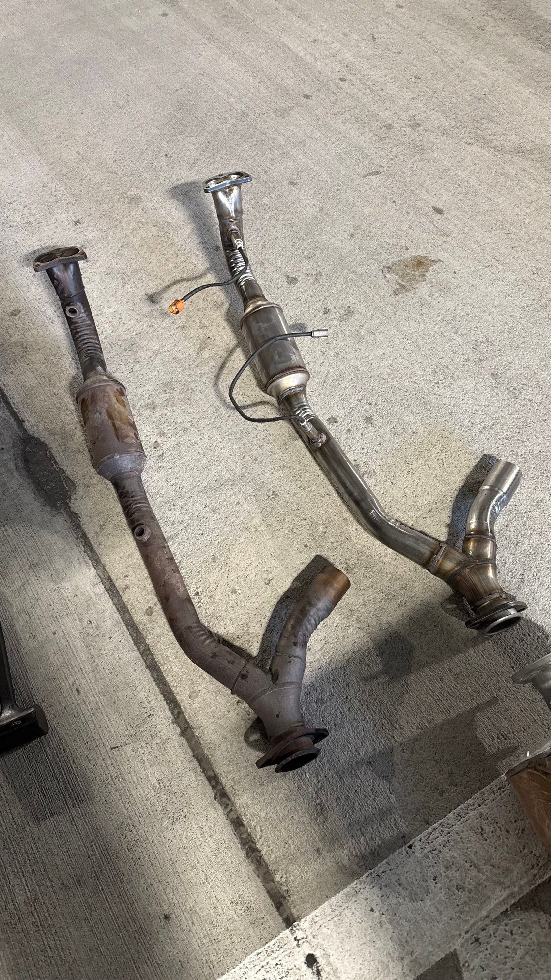

  • My exhaust was dented near the mid pipe causing a noisy exhaust leak anyway, so I dropped the cats section, moved the three "new" (read: now ~300 mile) not damaged Bosch sensors to the new Y-pipes, replaced the passenger-side downstream O2 sensor with a new one, and put everything back together. Making extra sure to keep the wiring away from any critical drivetrain components

  • My new issue since this saga is that almost all of those SES codes reappear on the dashboard, but only at startup. So now, when I get ready to drive anywhere, my startup procedure is:
  1. Start truck
  2. Plug in code reader
  3. Read codes (all codes from above are returned except: )
  4. Clear codes
  5. Drive truck like normal
  • It doesn't matter how long I drive for, the codes never come back once they're cleared. But the second I turn the truck off, doesn't matter if it's for 5 seconds, 5 minutes, 5 hours, or 5 days, as soon as she starts I get the codes back
