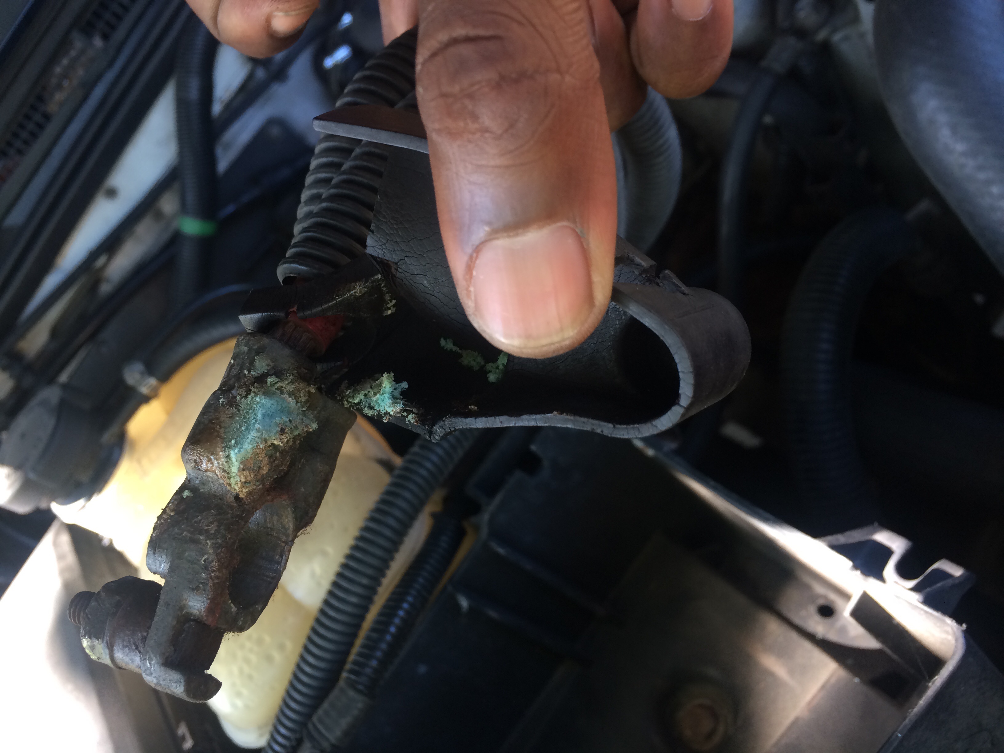

Is below a bad enough case of corrosion to cause the problem?!

From: Boston Strong
most likely, it surely isnt helping

From: New Hampshire
That looks like a possibility. I have seen a few over the years that look fine externally, but somewhere under the insulation, the wire goes bad. Usually, it happens on the ends, but not always. Certainly clean it up, but keep that in mind.
Good luck.
You'll get it going!
