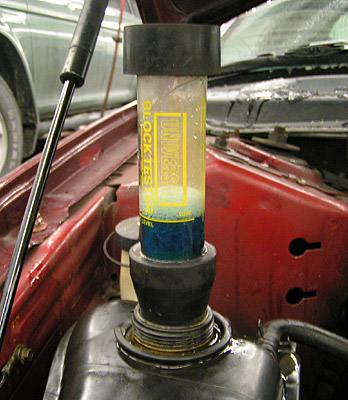

Well, you could have gotten a radiator by now. And you will probably still need one. Did the white smoke come out the exhaust? Or just steam under hood from a busted hose? It was not blowing any heat because you were low on coolant, just steam in the heater core and in the top section of the engine (intake manifold) where hot water for heater comes from. So you could have had a coolant leak, got to a low level, got hot, popped a hose, steam out the back of the truck, but not out of the tail pipe. If you put coolant or just water back in it, can you see the leak? You may have just popped a hose. You need to fix the fan(s) for sure, and maybe the rad.
Before you assume HG, if you can't see a leak from the head, you would want to do a chemical test for exhaust gas in coolant, or look at your oil for being converted to a milkshake, or have white smoke out the exhaust after warm up.
If you have experienced a head gasket failure, the repair parts are about $300, the machine shop will have a modest charge to smooth out the warped heads, and it takes an average shop mechanic 12 hours. Many DIY report two weekends, with machine shop inbetween. Indy shops get $1700 - $2300 for the whole job.
Here is a pix of a HG failure that vented coolant out the rear of the engine, very common at front or back because that is where the gasket is thinner horizontally.
Attached Thumbnails She's Overheating: Heater Core? Radiator? Head Gasket? Now it's a party.-block_test_fluid.jpg   She's Overheating: Heater Core? Radiator? Head Gasket? Now it's a party.-hg-rear-2.jpg

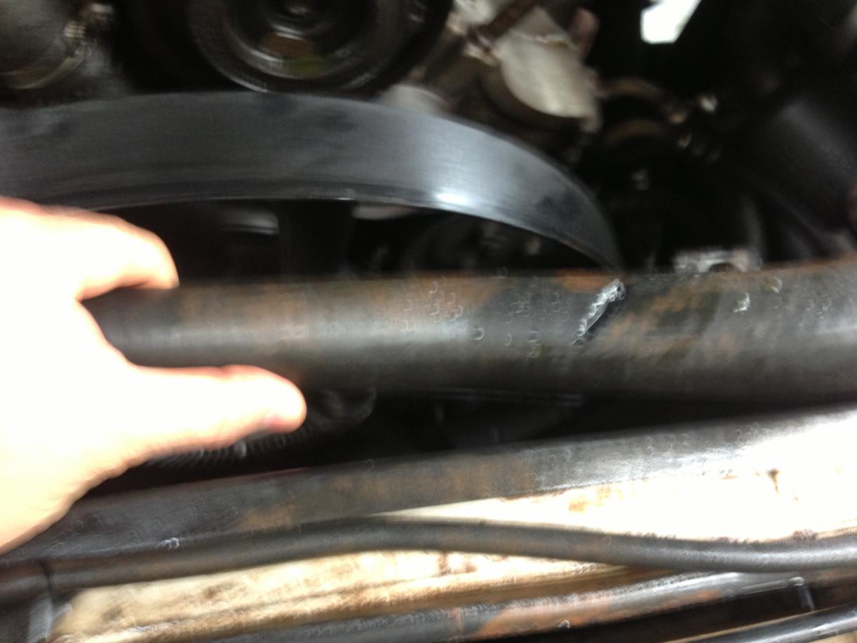

I found the culprit. The viscous fan was swaying back and forth so much that it cut the hose that feeds to the radiator.
The same thing happened in Aug of 2011, only the viscous fan took out my water pump too.
What makes this thing move around so much?
