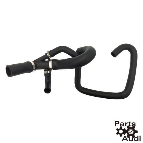

I tried doing a Google search and a search on here but couldn't find what I need. I'm trying to find the short hose that goes from 3 or 4 way flange to the water pump. I don't need the whole thing with all the other hoses but that is all that seems to be sold online. Or if someone could measure the size of the pipe the hose goes on the water pump if they have an extra or old water pump that would work too. The parts store by my work has lots of generic hoses but I need the diameter.

No, they only list the part that has the 4 hoses with the flange and a complete coolant hose kit that has all the hoses in the cooling system. I have a feeling I'm just going to have to take it off and take it to the parts store to match up. Not really what I want to do but it's better than buying a bunch of hoses I don't need.

Originally Posted by Friday Night Disco
Lower Radiator hose?
I don't need all of those hoses, that whole thing was replaced just before I got my D2 and one of the hoses is different now since I did the inline thermostat mod. I only need the short 4" one that goes to the water pump, far left in your picture.
