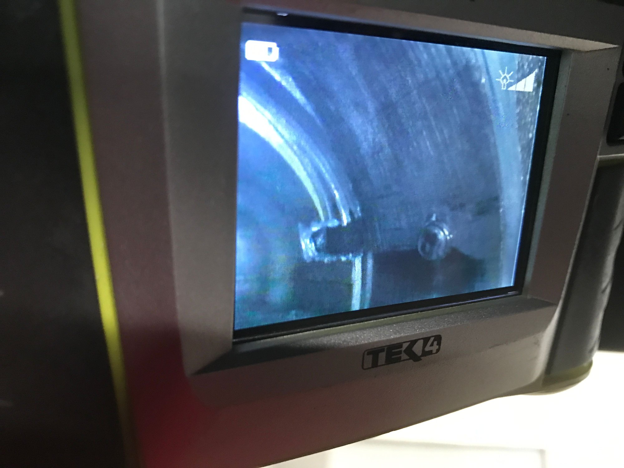

Here is a picture. You can see how the grub screw is through the liner and has shredded the piston on its downstroke. Ideally I'd like to be able to repair this one piston and liner from underneath...

Thanks for the advice mate. The liner is screwed. I tried posting a picture. The grub screw was actually drilled through the liner so when the piston came down it shredded the side of the piston. With a hole through the liner im guessing its cactus.
Does anyone know if I can replace the liner and piston from underneath through the sump area? There is oil in the piston top so I'm sure that oil is leaking up the side of the bore now so the piston top is cactus and this probably explains the low oil pressure.
If I can get away with replacing liner and piston top from underneath it could be something for me to look at. I've read you can dismantle from underneath but not sure if you can reinstall.

See grub screw penetrating lining and shred where piston has come down and hit it

The block and sleeve are tapered, sleeve can only come out from the top
