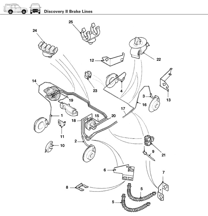

Hi all. I recently changed over to braided brake lines, but found a couple of small rubber brake lines attached to the chassis in the left front wheel arch. Are these replaceable with braided items also? If so, does anyone have a link to where I can buy them?
Thanks

These: Discovery II Brake Lines
But they are over priced in my opinion.

Originally Posted by jafir
Thanks for the link. As I have already installed Britpart lines to the 4 wheels, I only need the 2 small pipes in the wheel arch. Are they available seperately?

Product Details - Land Rover Parts | Rovers North
Or...
It looks like the modulator to pipe hose from AB is the same part, is braided, and costs less...
Brake Flex Hose Connects Between Modulator And Pipe (SHB101350SS Same Fit As Part # SHB101350) - Land Rover hoses from Atlantic British
Is part #5 in the attached photo what you're looking for?

Originally Posted by willrok13
Thanks Willrok, now that I know what they are called and have a part number for the OEM part I'll chase around to find some at a good price.
Check the edit I made to the post above your last one. Those things are tough to find but I'm pretty sure that's the one for $39. I may just order some too...

Yep they are exactly the right ones, thanks. Will have a scout around and see if they are available in the UK, and will post my findings here
Thanks again
