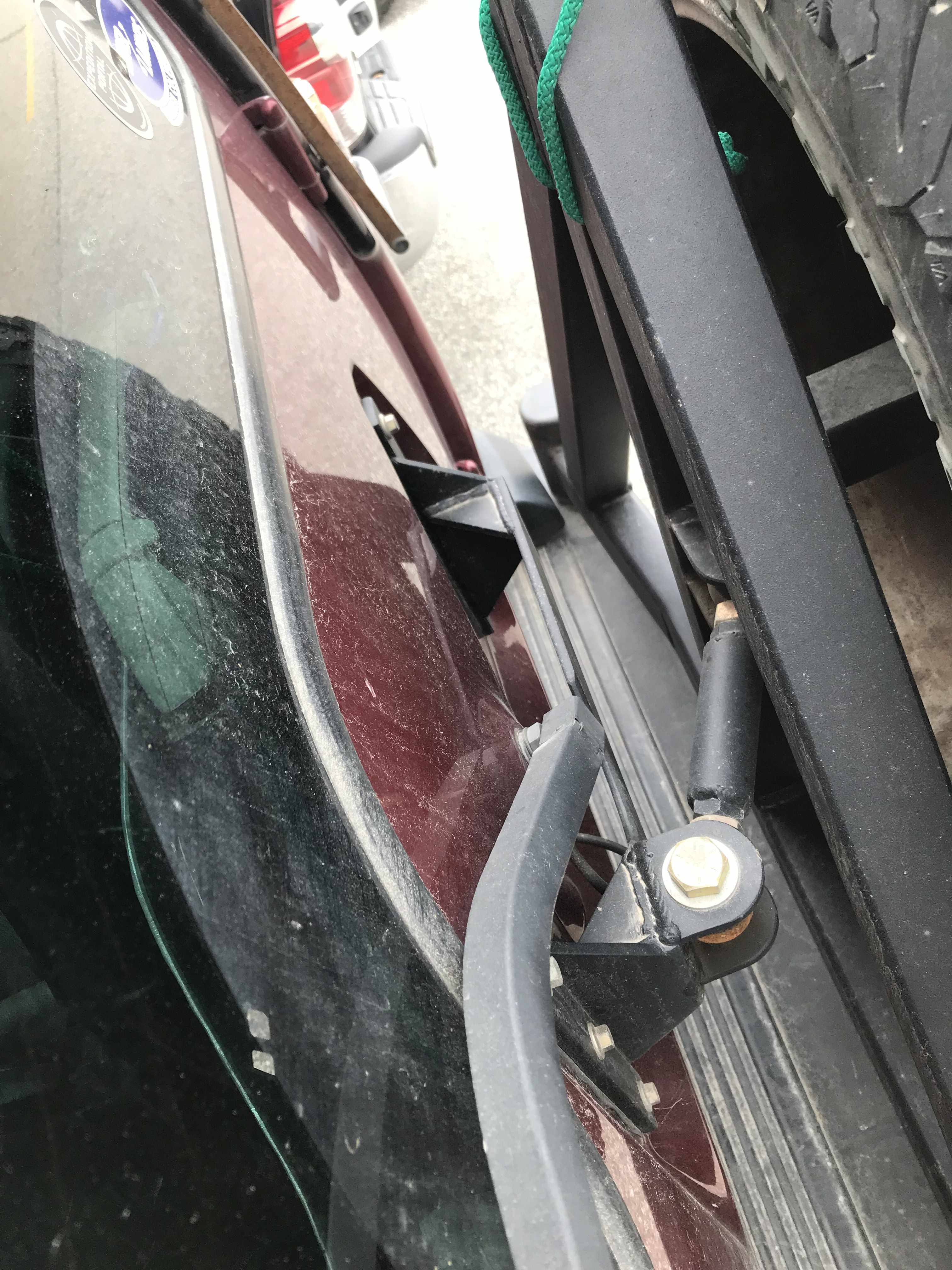

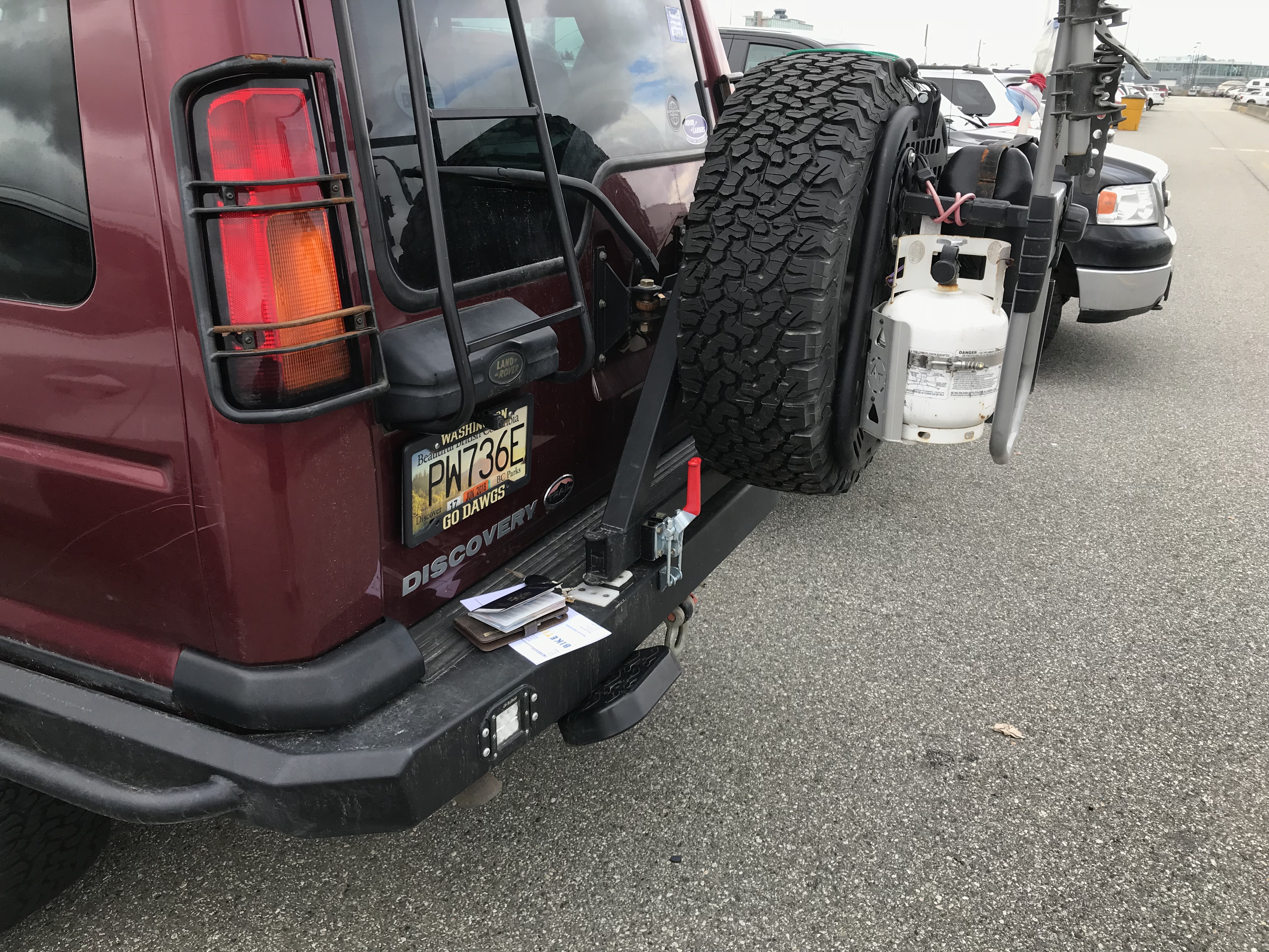

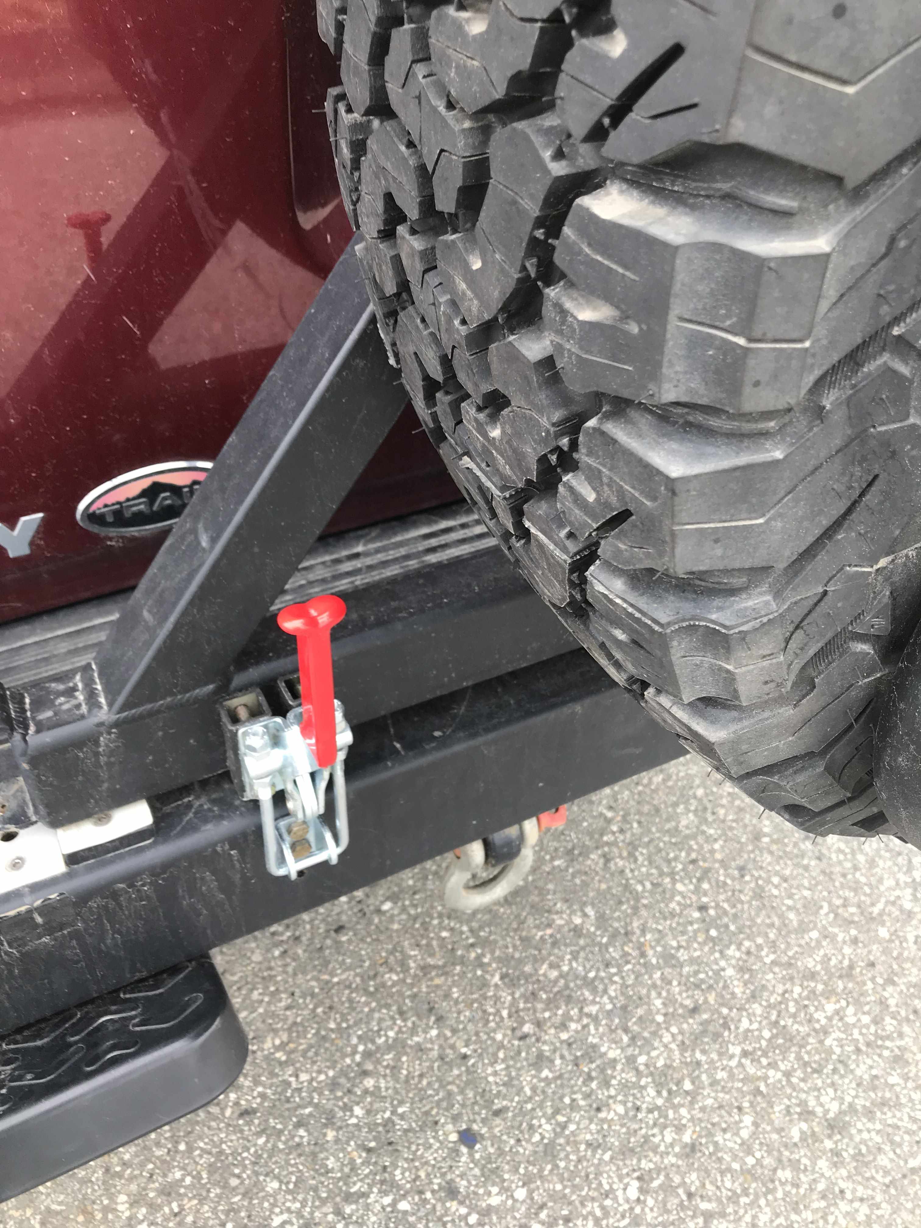

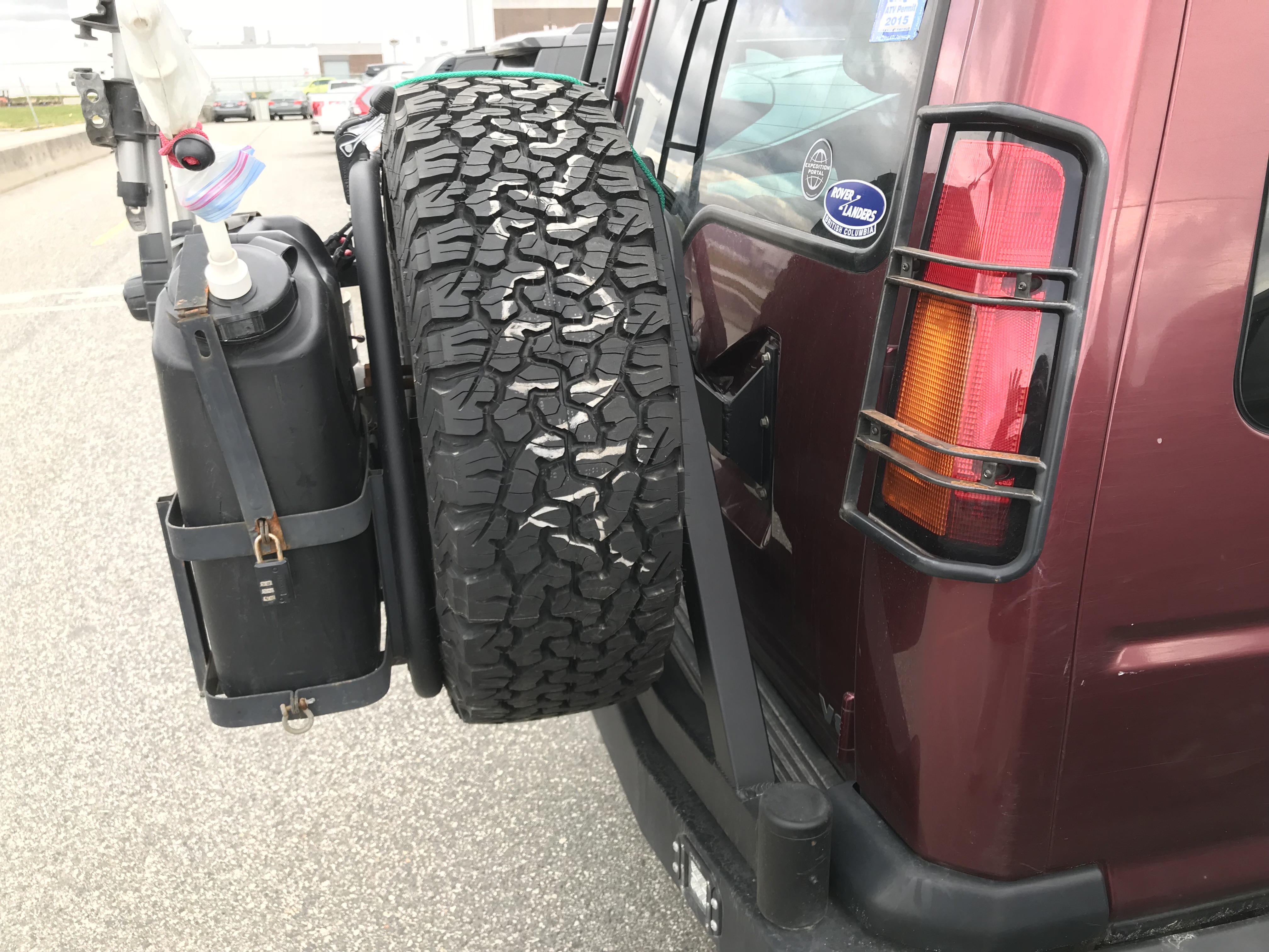

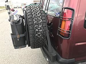

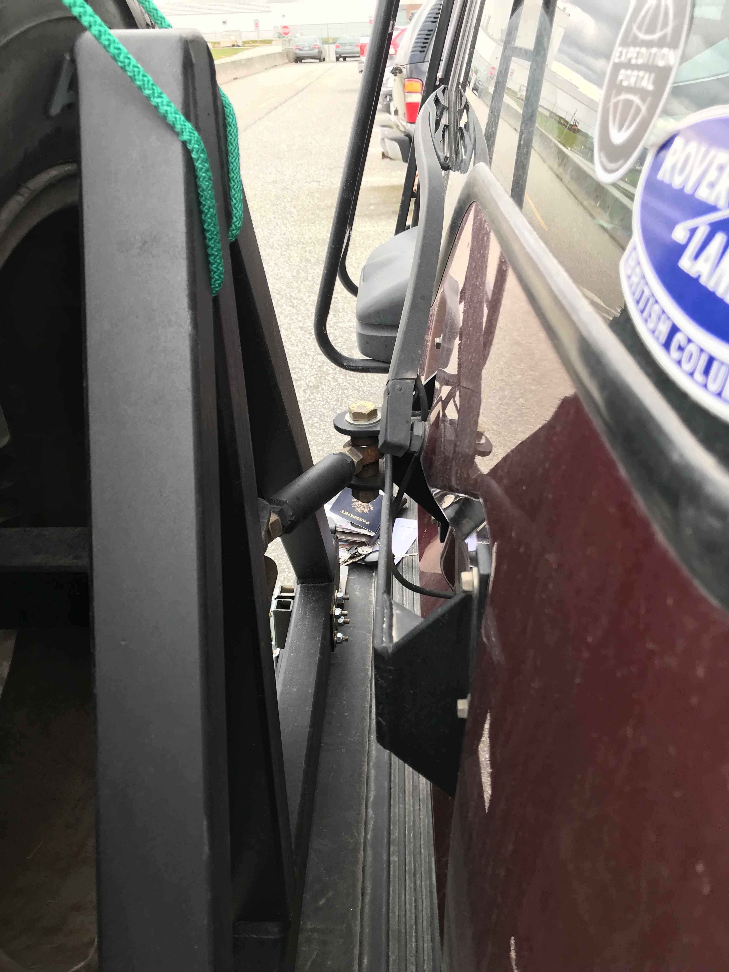

If you are still looking for ideas.... I have my swing away attached via a linkage to the rear door. This allows the swing away to open with the rear door. The linkage to the rear door is attached to a modified factory spare tire carrier bracket.

That's a cool design too, a guy on discoweb has something similar. For me, the benefit of having a fold down table outweighs the benefit of being able to open it with the door. Flat surfaces are a premium in the bush, and carrying a separate table is an awkward hassle.

Personally, l'd rather have the tire and door swing the same direction, that way you're not walking around a protruding item on each side of the vehicle. This would get annoying to me, but l'm old an tire easily. Another thing, over on the Overland Expedition site...a guy had his latch break and his tire carrier hit the guardrail. Which l'd prefer...over oncoming traffic. Guess you could build-in a an extra safety latch or something. Just throwing this info out there for further thought.
As far as a table goes...l've been thinking about taking a piece of plywood, 3'X2', and add a piece of angle iron on the back edge, with two steel dowel pins on each end of the angle, add some sort of simple bracket to the quarter panel of the rover that only protrudes an inch or less (make them rounded on each end to not get caught up on branches and stuff) that the dowels can drop into, and have a rope that attaches to the rack for the outer edge. A 3X2 piece of plywood is pretty easy to store. Anyhow, just more thoughts.
