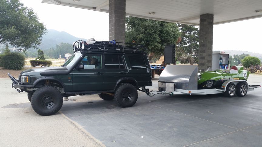

Last year I towed a car on a two axle flatbed from Southern California to Northern California and back. Didn't break any speed records and the rear springs definitely compress a bit with the trailer. With the lift the Rover is not exactly the ideal tow vehicle but it did okay.
That's a nice looking trailer, and car. That spring compression issue is why i'm looking to go to a heavier rear spring also. I end up towing with my Disco at least once a week. Sometimes more often; i:'ve towed every day for a week+ before. Most I've had behind her was 7300lbs on curvy mountainous roads, without any trailer brakes.
These trucks don't win any towing awards, but if you know how to tow pretty well then they are extremely capable.
Nice galv frame. Your rig has all the goodies looks like.
Yeah, looks like it came with a very nice "passenger seat" option, too.
Also, looks like your car is a little to far forward on the trailer, by looking at fender to wheel clearance. Definitely could move it back a few inches to level load over trailer axles, and in turn help your rovers suspension immensely...and it will pull so much nicer.
Brian.
That particular passenger seat option has been on board with all my vehicle purchases so I am very lucky.
The car may have been slightly far forward on the trailer but I think it might be the camera angle. Thanks for the tip. I will check it out next time I load it up.
