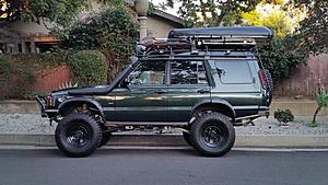

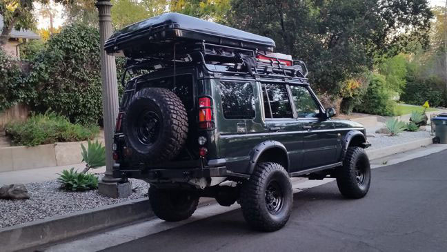

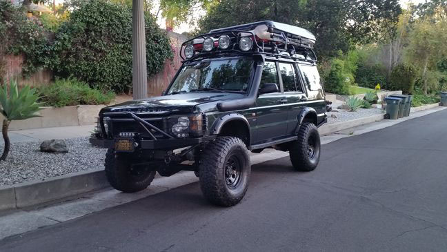

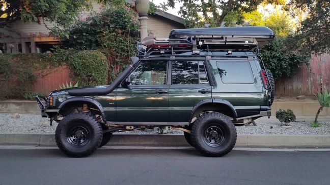

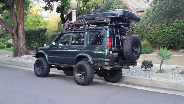

Sorry for the delay. Things have been very hectic for me lately. So the suspension/driveline details:
315/75r16 tires
6" lift with Terrafirma springs and dislocation cones
Bilstein 7100 remote reservoir shocks with Terrafirma shock towers
RTE 8 degree radius arms (front frame mounts moved 1-1/2" forward for tire clearance)
Ashcroft built front and rear diffs, 4.37 gears, pegged
Front ARB air locker
Rear Ashcroft air locker
Front and rear Ashcroft axles
Ashcroft heavy duty CV joints
RTE diff guards (rear has 3rd member skid)
Slick rock front quick-disconnect sway bar
Rear quick-disconnect sway bar with extended bump stops
Rovers North heavy duty steering rods
Tom Woods double cardon driveshafts front and rear
Attached are a few pics from when I was test fitting things to the roof rack.

That thing is a beast! Two thumbs up.

That tire and lift size looks perfect!

4.37 gears are what I was looking at. Do you like that ratio or wish you had gone lower? I've been leaning towards 4.37 but also thinking about 4.56 which, if I recall my math, would be a touch lower than factory where as 4.37s would be about the same as factory with 35s.

Dammmmn john! how did you get 6 in of lift with terrafirma springs?
alex, use the ratio calculator on Ashcroft transmission website. You want 2700 rpm @ 70mph in top gear.

Best looking D2 I have seen!
I'm happy with the 4.37s. I think 4.56s would be a bit better off road but you would definitely be hurting yourself on the highway runs.

No doubt that is a sick looking rig.
