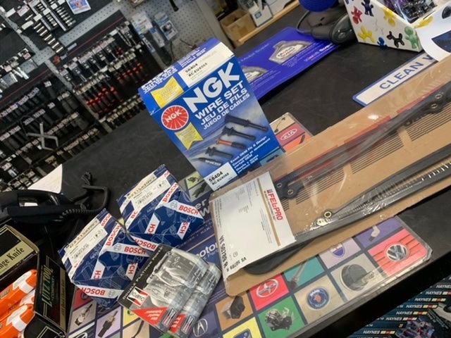

The things we do when we're bored.

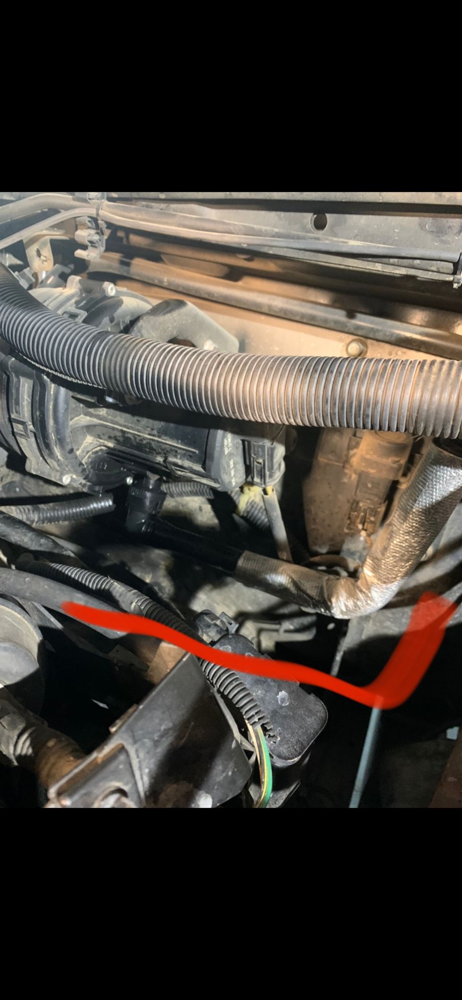

What is this piece called? I broke it lol
sai line?

Found it. I was rushing and broke it
https://www.roverparts.com/emissions...on/WAH100150G/

Did you break the connector or the hose? The hose is an easy fix to save you money.
just going to get a 3/4 hose, the connector still good.
