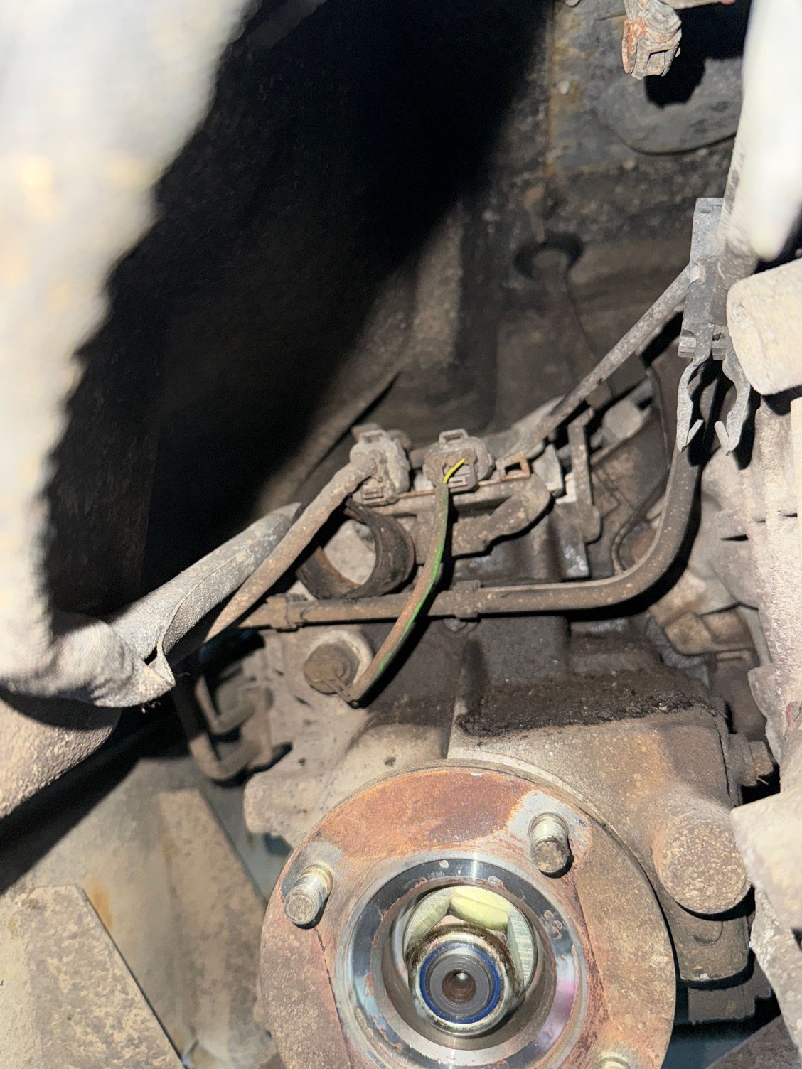

Originally Posted by Extinct
If you remove the driveshaft and disengage the CDL the vehicle will not move. You have to engage the cdl for the truck to move with the driveshaft out. After that, doing the test with the vehicle on jackstands with the cdl disengages will allow the wheels off the ground will allow those wheels to roll. This will allow you to determine which end is making the noise. With the wheels off, you can likely figure out which component is making the noise - hub, brakes, differential, etc.
Wait a minute.... shouldn't the bolt for engaging and disengaging the CDL be there on top to the right? BTW driveshaft seems fine.

Unfortunately, Land Rover removed the CDL nipple from late 2001 through 2003.
Only 1999 - early 2001 have the TC with CDL nipple and 2004's got the CDL engagement lever as well.
