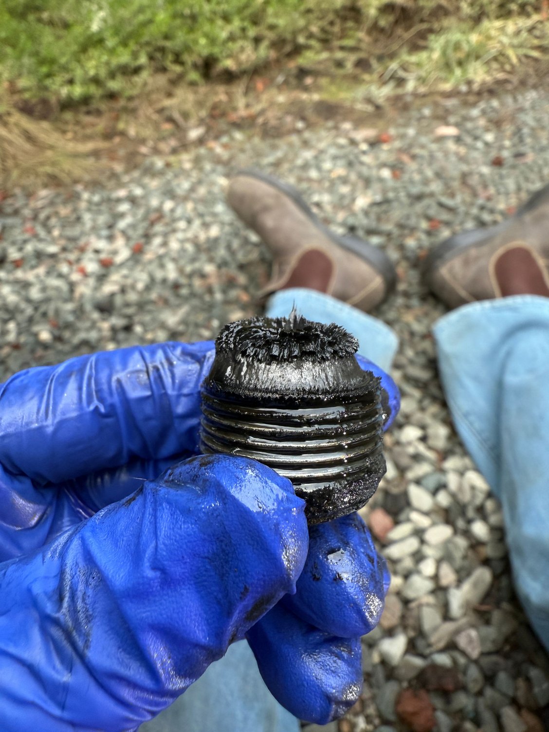

I ordered a new drive shaft from Tom Woods. Probably should have put it on and tested to see if the noise was fixed before draining the diff but I wasn't thinking and was really curious to see how the drain plug looked. Quite a bit of metal if you ask me.
Im going to change the fluid put the new drive shaft on and see what happens.

Aye, I’d set your expectations at needing to replace the diff. It’s really not a difficult job at all.
